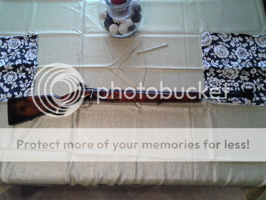

Toz T03-12
still have one and I have had a few, I have a target here I shot at 50 yards with american eagle, 10 shots under a dime, deadly accurate rifles no matter what you feed them for ammo
mine shoots lights out with american eagle of all ammo, the 50 to a box stuff, not the crazy 40 to a box, easy to get those 2 confused
Mine seemed to like Velocitors. Had a guy hound me to sell it and offered more than I could say no to so she went to a new home. Nice gun to shoot.
