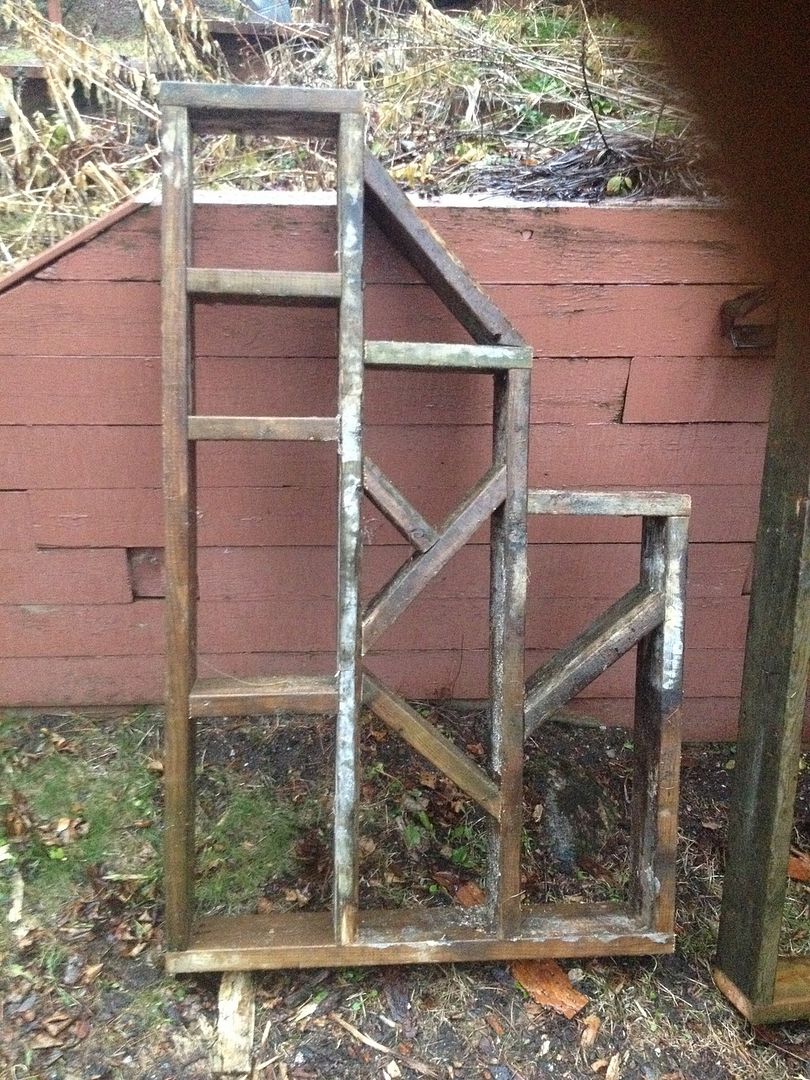

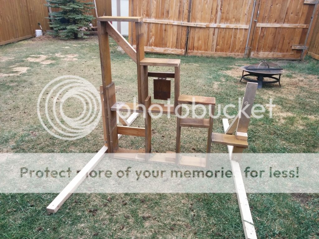

Guess I will start this off with 2 barricades and an adjustable roof pitch. These have all been built to so I can dismantle them for transport.
This is built to the specs of the PRS tie breaker barricade.
This one has the same foot print as the one above.

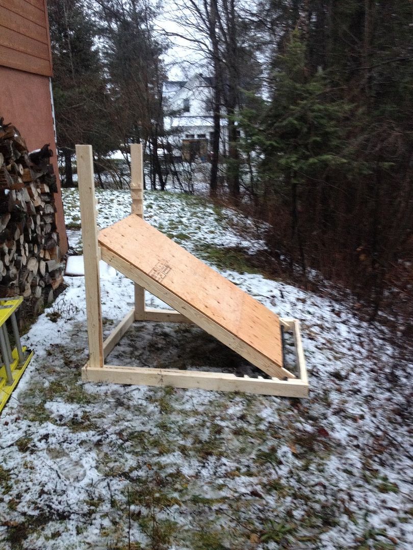

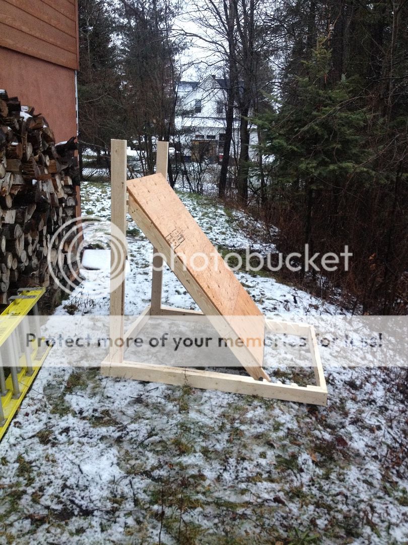

I designed this so I could practice off multiple pitches of roofs because there is no standard pitch for PRS matches. It is almost 4' wide and 5' long and adjusts from a 6/12(29deg) to a 14/12(49deg). Plan to shingle it for grip and weight so it dose not move around.
I will be using these in my training program I am working on. I will post this up in a couple weeks.
