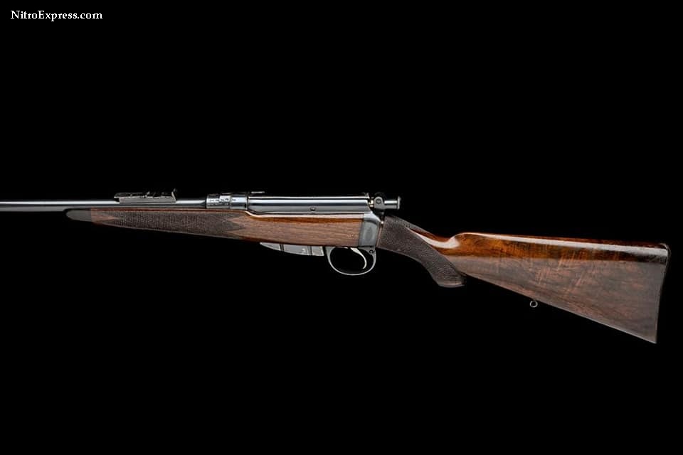

Stalking rifles were either repeater or single shot. Had pancake/oval cheek-piece, buffalo horn trigger guard and fore-end, double set triggers, open sights, light or heavy scrolling, external hammers, peep sight, bullet/cartridge trap, grip cap bullet trap, schnabel.
Westley Richards 425 missing the forend I believe to be horn.Note the cameo cheek piece.
