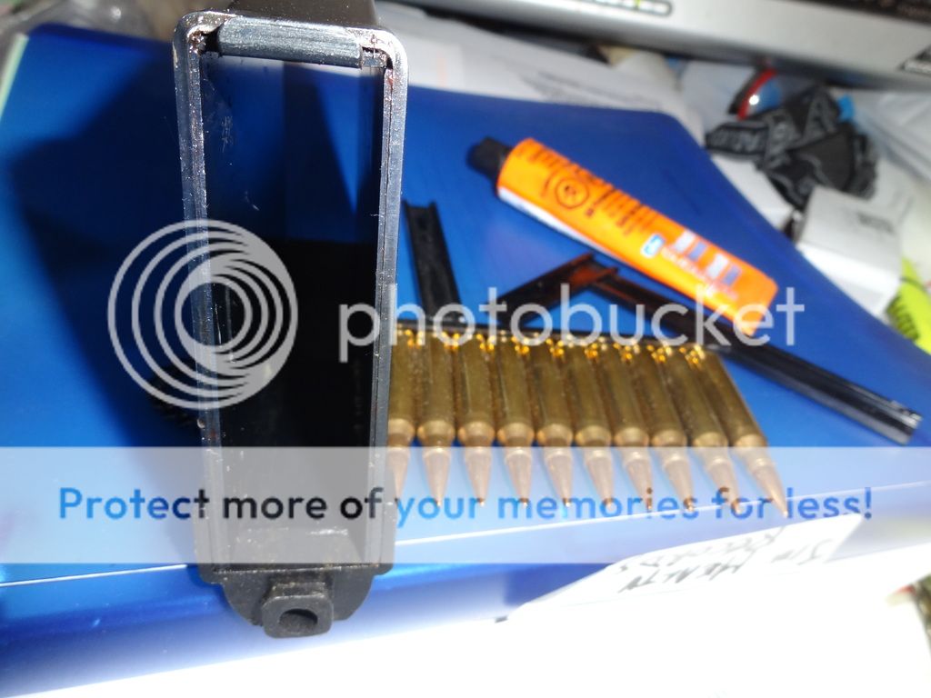

I once saw these repro trench mags on sale for about $35 each, so I bought 2 of them.
They installed on a pair of Mauser 98s perfectly fine. A VZ 24 and a FR8.
Last weekend I shot an ORA Sporting Rifle event, which involves shooting a series of 10 shot shoots. The Snap and Mover allow about 8 seconds between exposures for reloading. Since a Mauser is only 5 shot magazine, and controlled feed, it means that after the 5th shot a new round has to be tucked into the magazine. If the rifle has a scope, this can be a bit awkward.
So I decided to try the trench mag with 10 rounds in it.
It worked perfectly. Or almost perfectly.
To make ammo feed properly, I found I needed to block the mag at the back. To do this I took the spring/follower out (the bottom of the mag comes out, too) and I glued (Dollar store contact glue from a tube) a plastic 5.56 stripper clip (1 ½ clips) up the back of the mag. I also glued a piece of stripper clip up the back of the rifle mag well.
The magazine follower needed a lick on the grinder wheel to shorten it a bit so it was a nice loose fit in the magazine.
The only failure was twice the round did not pop all the way up and the bolt passed over it. I saw/felt this happen, so was able to open the bolt, poke the round and then chamber it.
If you remove the mag, the spring and follower fly out because there are no lips on the mag. So you push the follower down into the trench mag and then insert the key across the mag, to hold it into place. You can see the slot for the key in the picture.
it really makes installing the mag so much easier.

I just tested the magazine. Holds 23 rounds of 308.
When cycling the rounds through the action, sometimes a round fails to pop up into place. A lot of internal drag in a big mag like that. But when shooting, the recoil shakes everything well enough to make sure the next rounds pops up, ready to be stripped out by the bolt.
I just glued some plastic stripper clips into the back of the mag and rifle mag well, to reduce the well from 8mm length to a bit shorter, so a 308 round is pushed forward, so it will feed smoothly. I used 5.56 clips as the spacer block and contact cement to hold them in place. These pictures should explain what I did.
