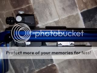

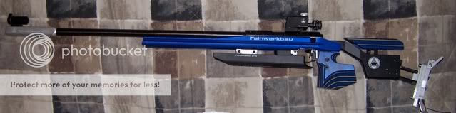

Here are a couple of pictures.
3P Rifle
Benchrest
Valmet (shows forend stop)
