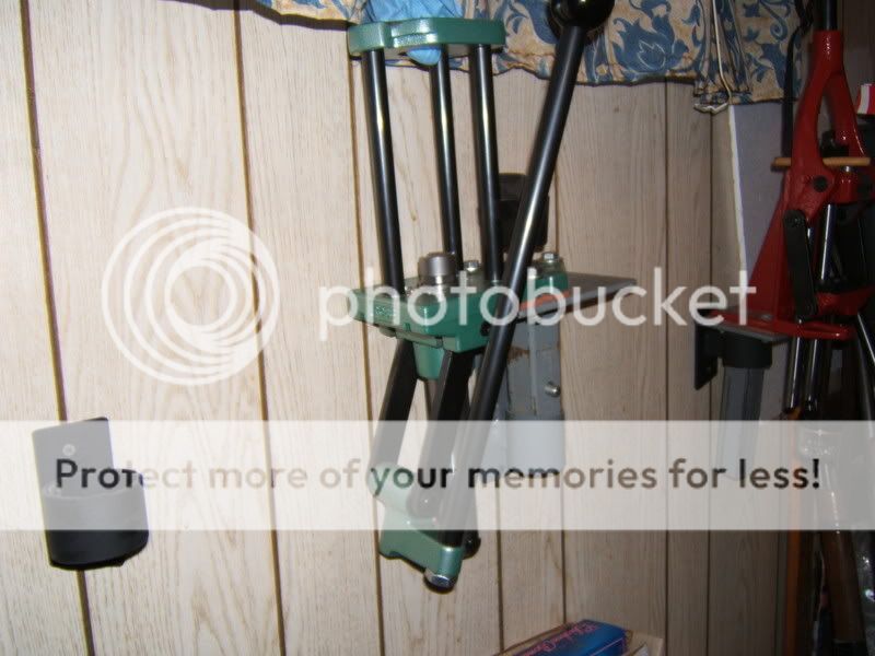

I built a tripod for my presses. Top of it is a square tubing 2" ID. Each press is bolted to a base with another square tube which slides into the tripod piece. Also bolted my trimmers to similar bases so they can be mounted to the tripod. Then built similar recievers and bolted them to the wall for storing the componants when not in use. I'll get ya some pics this weekend if you're interested.

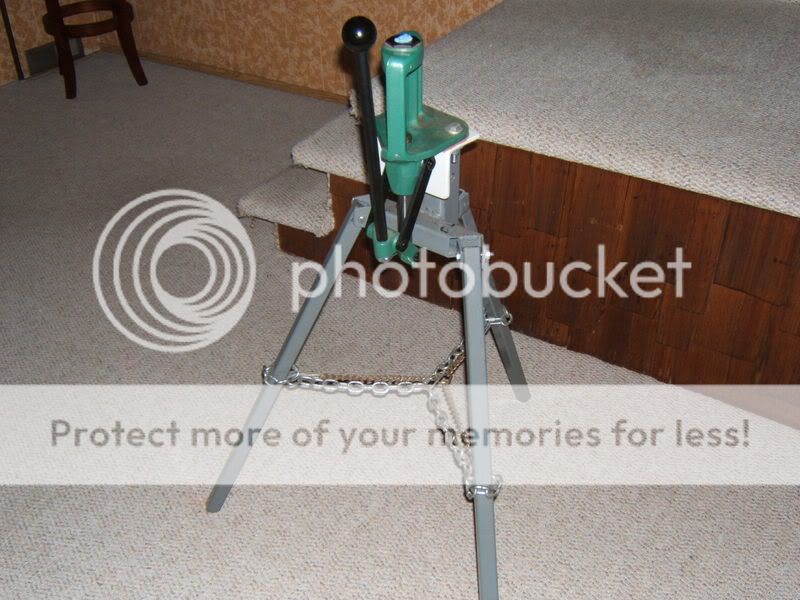

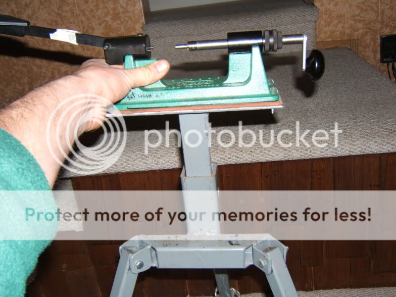

Here Fog....don't know if it'll help ya but....
The manner in which I linked the legs to the top leaves a little to be desired....under hard torque it will rock a bit.....I already welded the rear leg solid to help. Gotta re-engineer it....one of these days...

dmay..thanks for more idea,s and the pics, on the stand..make it universal to fit all the gadgets......:)
about how high is it dmay?
Fog.....good plan I think....my folding legs disappointed me somewhat, as stated, due to instability. And I've never folded the dam thing up to take it elsewhere anyway.:D Gonna redo it one of these days....one of these days....
