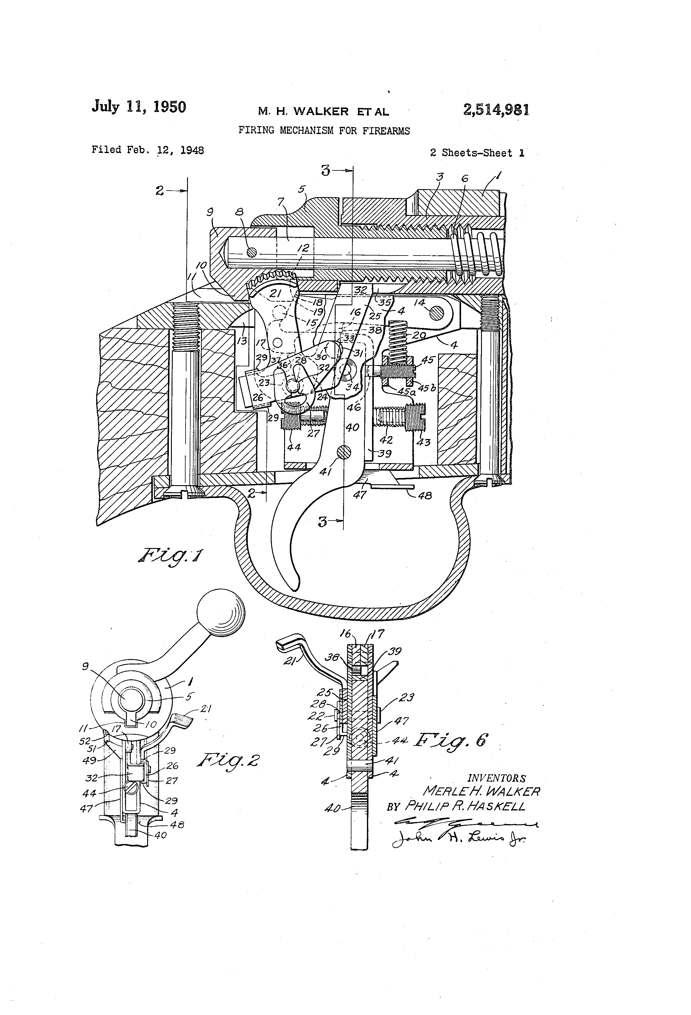

If you do some searching for patents, you may find some of the information you're looking for. For example, here's the patent for the Walker trigger design used in Remington 700s: https://patentimages.storage.googleapis.com/7a/dc/77/5875de9d061927/US2514981.pdf
