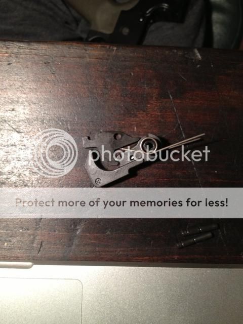

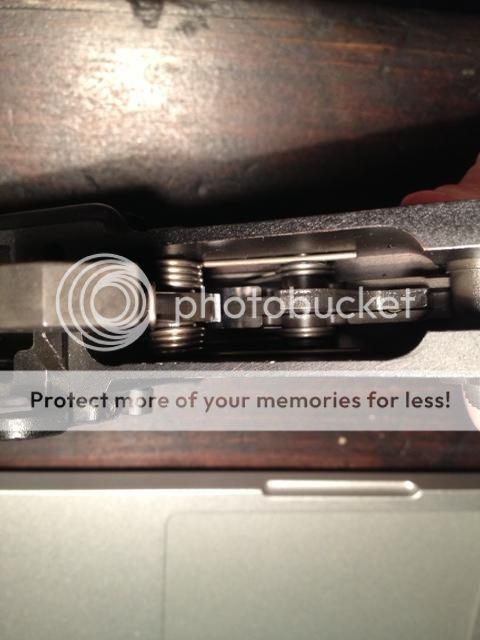

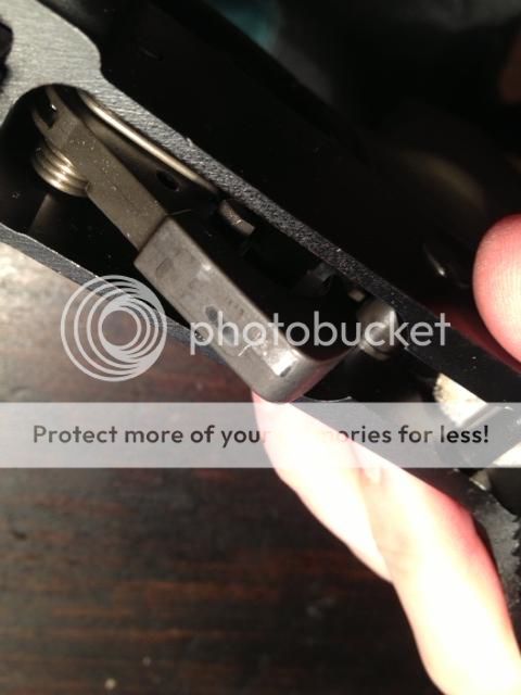

I took a few pictures to help show the issue - any thoughts of what might be causing this all of a sudden ? I have been issue free with this trigger assembly for about 500 rounds thus far.
This is how the disconnect malfunctions, even after the trigger is let go to reset

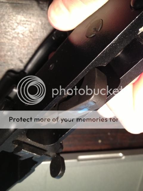

I cheated to replicate how the hammer is held by the disconnect even after the trigger is released below

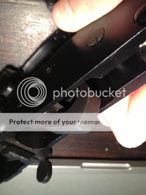

This is how it should sit when released
Can anyone tell me if the disconnect spring should be installed with the large end up or down within the trigger ?

Could you do a trigger pull weight test? Everything looks assembled correctly. Does the trigger stay back on it's own your do you need to push it forward to reset?
Moe
The disconnect is correctly oriented. Check to ensure that you have a correct disconnect spring installed.
The hammer spring appears to have some set as well. It should be straight and not bent at the coils.
Not disconnecting could also be caused by a weak or incorrectly installed trigger spring, or some foreign object under the trigger preventing re-set. I've seen this caused by a popped primer - just the anvil portion working under there.
