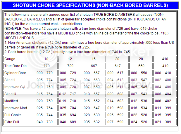

I know there are a100 threads on this already but I had a new thought on it. I have a couple of single shot cooeys (just like everyone else) and I'd like to be able to shoot steel through one of them. They all have a full choke in them and I'm told I'd need it modified to somewhere between a modified to a skeet 1 to safely shoot steel out of it. Most local gunsmiths don't even want to look at a 100$ gun and the ones that do say that there isn't enough steel in the barrel to bore it out or thread it for Interchangeable chokes, and if they did either it would be a $150 job, but they still won't. My question is can't the end of the barrel be trimmed back to reduce the choke to something less restrictive? This could be done on a lathe a few thousands a t a time and the muzzle measured with a micrometer to test the progress, couldn't it? I know this is kind of a "backyard" mod but it could help get lots of Canadian made guns back out in the field.... Maybe.
