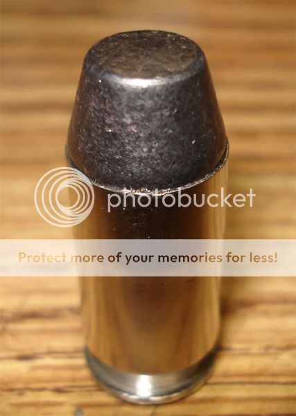

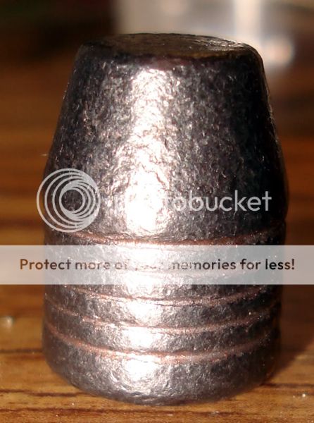

I had been having trouble feeding truncated cone hardcast
that had been feeding perfectly last summer. All other profiles from ball to hollowpoint fed fine. The couple wadcutters I had on hand showed no problems either.

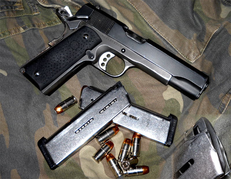

In looking things over and double-checking with folks at other sites I figured the magazine springs should be replaced first as there are less than 500 rounds on the 18.5lb recoil spring.
Tripp hybrid conversion kits came yesterday.
These are just awesome!
The followers are hybrid and are of high quality.
I only had one bobble with the feeding - the first time I charged manually from slide stop. I pulled the slide back fully and it rode up fine.
I wouldn't mind finding a wadcutter profile bullet mold, but I really like this truncated cone style and want it to feed perfectly again.

Overall, I'm very impressed with the Tripp conversions. Might have to spring for a Cobra mag to help feed these TC bullets as I've read they're more inline than other mags. We will see. I've never seen anything feed quite this slick before -- including my much-loved tapered-lip GI mag with GI hardball! I consider that the supreme setup for hardball use, so that says a lot!
I wish I'd not waited this long to order. Now if the spring life proves good, I'll convert my practice mags over, too!
