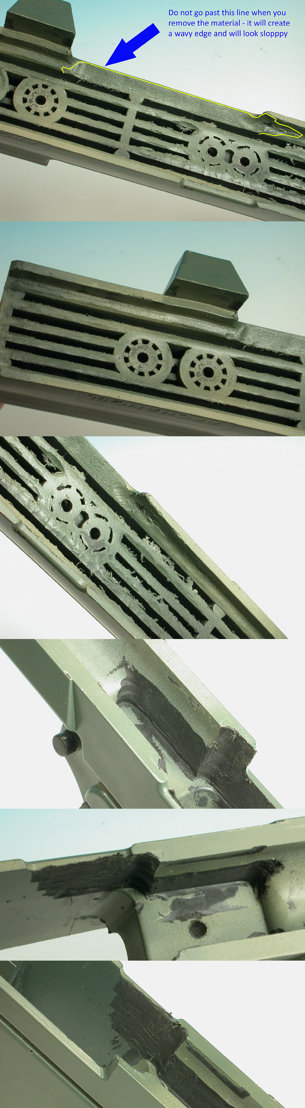

I used a dremel and was surprised how much material I had to remove to make a custom fit. But now its in there solid, no rattles. It really is a good, tight stock for the 10/22.
Ill try that, would it be possible to take a picture of where exactly you took off most of the material. Its my first mod so im a bit apprehensive.
Thanks for the help.
it was almost entirely from the upper part that has the 4 screws going in to the 10/22 reciever. A *lot* of trial & test fitting..it was my first mod too, so I know what you mean. Once you get it close, start looking for other areas that might be interfering with the fit. Really try to locate those - I wasted a bit of time dremelling out areas I thought were contacting the 10/22, but actually the problem was somewhere else.
Never had a prob with mag fit, other than the BX-1 10 rounder, which kind of gets lost up in the mag well. I have yet to try firing my GSG110, but the fit is solid:
OK, I took it apart to photograph. Not sure if it gives you a better idea what needs to be done, and it may even be different as the fit could vary from gun to gun. Main thing is to go slow. A dremel can get away from you in a hurry.
