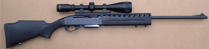

This might be an option:
http://www.remington7400.com/index.php
They look pretty neat when done.
