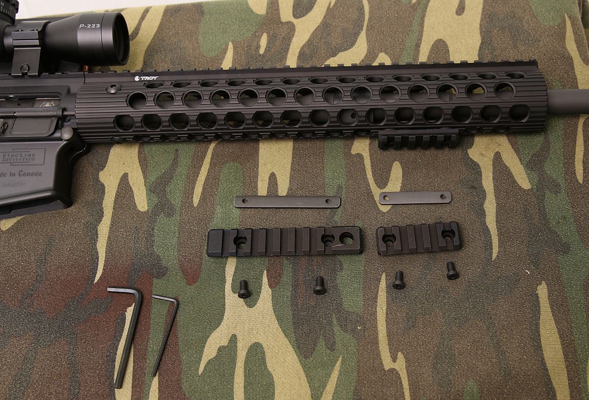

troy rail section
looks like the same holes as the original alpha rail, not sure vtac rails will fit. maybe someone else can confirm?
Last time I went to MilArm and checked out the alpha rails, the VTAC ones had a long thin "recoil lug" that fit into the elongated cooling slots, whereas the Troy ones look this this guy (Hard to see from the pics I could find; but they're more like a 1/2" diameter round lug):
Or this one
Versus the VTAC ones, which are a longer thinner
Bottom line, I don't think the VTAC ones will work on a troy rail.
Last time I was in at MilArm they were expecting a Troy order, but hadn't gotten it yet (waiting 1+ year since order), it may be worth checking as they were supposed to get it sometime this spring.
1/2" holes. The T-22 are the same as the TRX Alpha system. I looked for a year in Canada but could never find them. Ended up ordering them from the USA for a premium. It disappointed me that not a single Troy dealer in Canada would help me out. My loyalty to Canadian dealers died with this lack of support getting something so simple. Now I order everything I can from the US.
