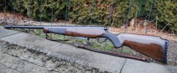

A couple with tru oil, BLO, and a lot of elbow grease. The mountain rifle has Alkanet hue in it as well.

Amateur here.
I have done it with Tung oil and found it not too satisfying, It gets shiny and takes forever to dry, no matter what. With Tru oil, you decide how shiny you want it to be, depending on how many coats you put on.
On a SKS I just put 2 coats of Tru oil on and it looked fantastic, basically like factory. To get the correct colour I want, I just used some Angelus or Fiebing leather dye off amazon which I did first. You have to use the dye very carefully.
I did not sand anything, just wanted a nice finish. Wait, maybe 220 on some of the rough spots.
