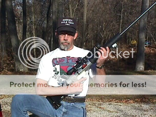

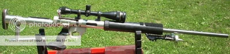

Why are they called tube guns?
What is the difference between a tube gun and a regular rifle?
What is the advantage of a tube gun over a regular bolt rifle?
- Called tubeguns because the rifle action is bedded into a "tube"
A - No bedding to contend with.
B - Unitized system; receiver, stock and handguard all inline.
C - Accepts any readily available right handed short action Remington 700 action.
D - Allows easy access to the trigger for repair, removal or replacement.
E - Allows easy access to the barrel for replacement.
F - Same system as used in benchrest for years without the bedding used in conventional stocks.
G - Accepts any readily available AR15 / M16 pistol grip or buttstock.
H - Allows one to easily change stocks or pistol grips to best fit the shooter.
I - Handguard threaded for bipod stud for tactical use.
J - Seamless transition for a shooter who shoots the AR15 system.
K - Action sleeve provides more strength to the action than a sleeve for a conventional stock.
L - Weaver type rail provided makes mounting the rear sight or scope an easy task.
m - Kit weighs less than 4 pounds so that the shooter can control the desired weight of the rifle through barrel selection and buttstock weight.
