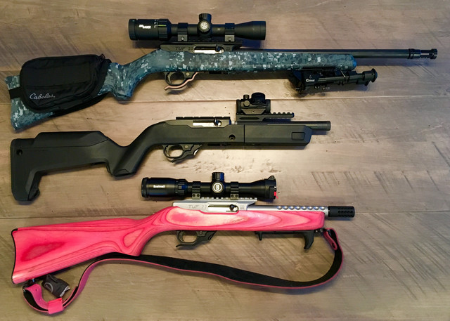

I own all of those except the Ruger 10/22 target. The TUF-22 receivers are second to none and I love the Dlask shorty barrels I have an 8” SS dimpled bull barrel on the wife’s pink ruger and a 9” carbon fibre medium profile on my take down. Two of these guns have TUF-22 receivers which will also take the legal TUF-22 hi cap 25 round mags. The takedown is cool but in reality if you run this short of a barrel you aren’t shaving off nearly as much overall length as with the factory length barrel. I hope Dlask starts making a TUF-22 takedown receiver soon.

What do you recommend as 1) barrel, 2) trigger stock and 3) stock?
I almost bought a Tikka T1x MTR but suddenly realized that a Gucci-ed 10/22 would be 10 time more fun ;)
Barrel - what exactly are you looking for? Short? Light weight? Target?
Trigger - the ruger BX trigger packs are the best trigger pack for the $ in my opinion I have them in all of my 10/22’s
Stock - really depends on personal preference and what you are going for if you are getting Dlask to build you a gun get the Magpul hunter with a longer cheek rest and skip the hogue
