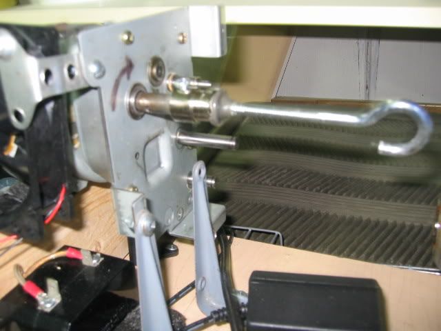

1. The 120V motor is from a dead heavy-duty copier, about 1rpm. I think you have it solved with a treadmill motor. I find mine running too hot for my liking, so I put it on a timer: 15min on/15min off. I also have a 24V fan cooling the motor off constantly. I run the timer & fan off a 24V transformer. The hook is JB-welded to shaft coupling, drilled and tapped for a retaining screw.

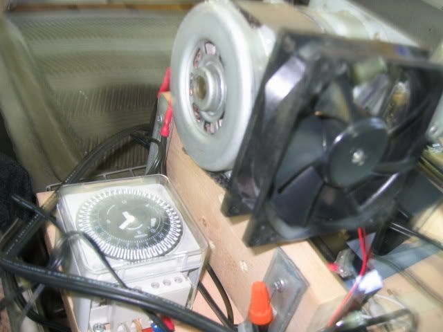

2. A better view of the motor/timer/fan. I didn't mean to over-engineer, I just had parts lying around. ;) The total tumbling time is under 3Hrs.

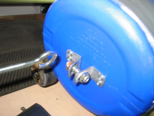

3. Coupling motor to the drum: my way of giving the rotating drum some slack:

I cheated:pand took the easy route and bought an RCBS Sidewinder but congrats on a great looking set up. Well done!! A quick question, did you put anything in the way of ribs on the inside of your drum to promote tumbling of the brass and media? The reason I ask is the interior of the drum on my sidewinder has a flat spot profile for that reason.
I had 4 aluminium ribs riveted inside my original drum, the one made out of a weight gainer jar. The rivets eventually begun to leak... I have no ribs in the current drum & found it makes little difference: the drum rotates at about 60rpm, i.e. fast enough to cause the load tumble onto itself instead of sliding. I'm sure having those ribs helps, I just didn't feel the difference would warrant the extra time to tinker with it.
