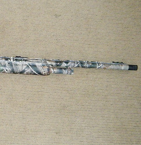

For reference, the aiming patch is a square inch. The shotgun used is a Benelli Supernova fitted with a 24" barrel and Briley Turkey choke.

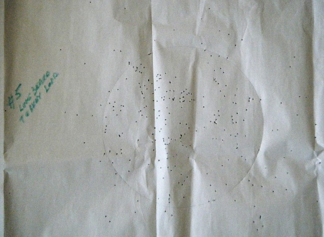

I tried some of these new 'Long Beard' loads from Winchester - I was impressed. Very tight shot column. This is a 10" circle at a measured 30 meters, 3" shell, #5 shot, from my 24" turkey barrel with turkey-choke:
That is a beauty of a pattern. My brother bought some of those Longbeards and, we are going to pattern them next weekend. What type of choke sk8r?
Extended turkey choke - Mossberg # 670 XX, on my Mossy 500.

Ported chokes can affect the Federal flight control loads. I use them with a non-ported choke and for me they can't be beat. I'll post some pictures on Wednesday.
Thanks SK8r, exactly the input I was after. Seems like a winner load as well. I'll try them if I come across some.
