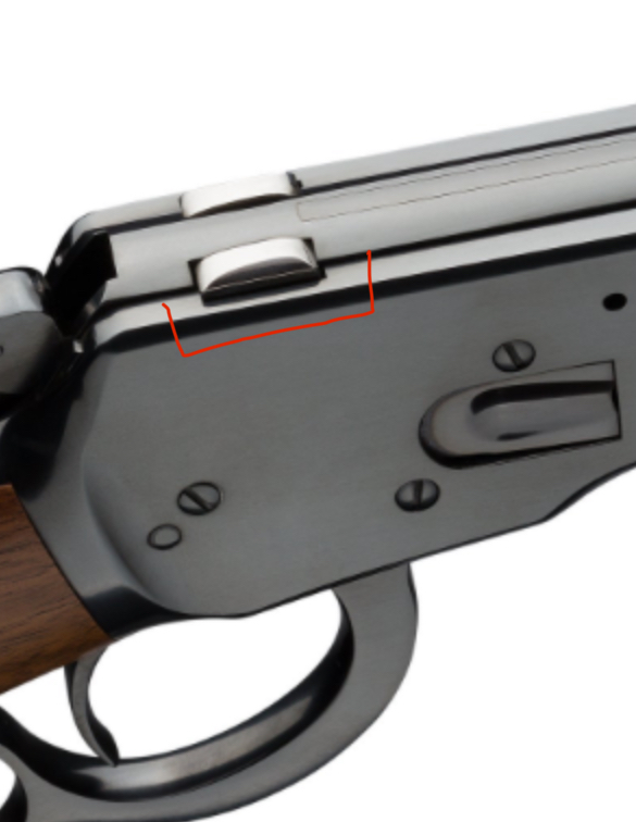

I’ve seen steel 92s with peened and setback mortises, last place I’d want a material with aluminums properties
Internals are steel, receiver itself is aluminum. I'm not familiar enough with the 92 design to know if that makes much of a difference though. Care to comment?
From what I can gather, the mortices are milled in the bolt, so as long as the bolt is steel, and the locking blocks that go into the mortices are steel, it shouldn't be an issue?
The area I highlighted is the area of concern, they are milled into the bolt but the lugs need support in order to hold the bolt, that’s where the receiver mortises come into play, it’s close to a 50/50 split
