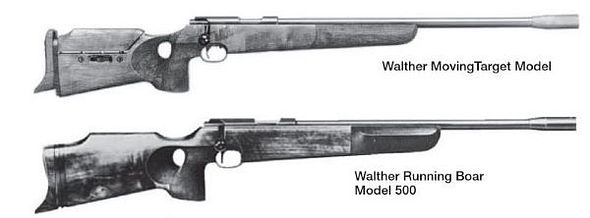

At one time that barrel shape was put on “running boar “ rifles. Can’t remember whether it was on an Annie or Feinweinbach ( spelling ?). I think IBI calls it their “Olympic” ( spelling again, it’s gonna be a bad day ) style
Running boar rifles don't have barrels that have "two flats" -- that is, a "flat" top and "flat" bottom (as opposed to round).
These rifles have round barrels that often have a removable barrel weight at the muzzle. Below is an image of Walther Running Boar (sometimes called Running Target) models. Anschutz Running Boar models look similar.
The barrel shown by Shorty has "two flats" which end about four inches before the muzzle, which may give an appearance of having an "extra" large muzzle area. It is in fact no larger than the original 1" diameter of the barrel prior to being flattened by having material removed.

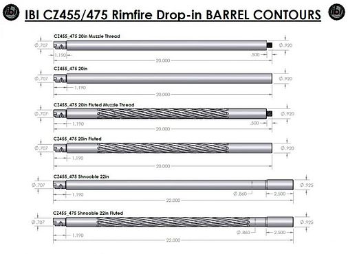

The IBI barrel referred to may be one of those shown below, perhaps the second from the bottom. It is profiled to have a "bulge" in the muzzle area. These barrels are round.
