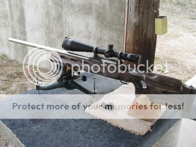

Stevens LA - Used on my F Open rigs (started life as a 30-06)
223 bolt head - to test my new Shilen F TR barrels and work up loads for the 90gr Bergers
Richards Lamstock
RB 2 trigger
Score Hi Single shot follower
Farrell MOA base
Burris Sig ZEE rings w/ inserts
Sightron SIII LR 10-50X60 FCH
Shilen SS Select Match 223, 7 twist, Bull contour, 28" finished, throated for the 90gr VLD's.

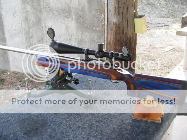

Stevens SA in 223 - new Centerfeed action
Richards Lamstock - thought I would be daring with the colour scheme this time. I like it
RB 2 trigger
SSS single shot mag adaptor. Yes, the det mag bottom metal is utilized.
SSS fancy bolt body. SSS stuff was purchased before the Feds visited.
Farrell MOA base
The barrel in these pics is actually the same barrel. I had the LA set up first for testing while I was finishing the SA. Same brass, same loads, same accuracy.

Did you hollow out the the forend so it rides on the outside edges?

NO time to build my own right now.
Farrell bases which I have used on all my rigs for a long while.
Dead flat bottom at this time. I set up my front bag so there isn't a hump in the middle so dishing the bottom of the stock is not necessary.
Jerry

Jerry how is the short action working for the 223 with the 90's seated out to the lands?

No issues single feeding in the SA. With the bullet out around 2.6", no way it will work from any mag. Action can easily work with 3" OAL.
Just starting LR load tuning so got alot of lead to send downrange but so far results are very exciting.
