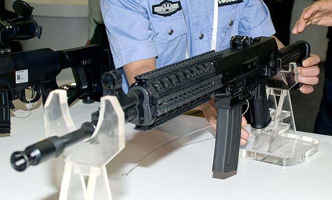

They already make one, export version of the QBZ03/Type03.
You just need to beg somebody willing to make a big enough order to be exported. Like North Sylva.
