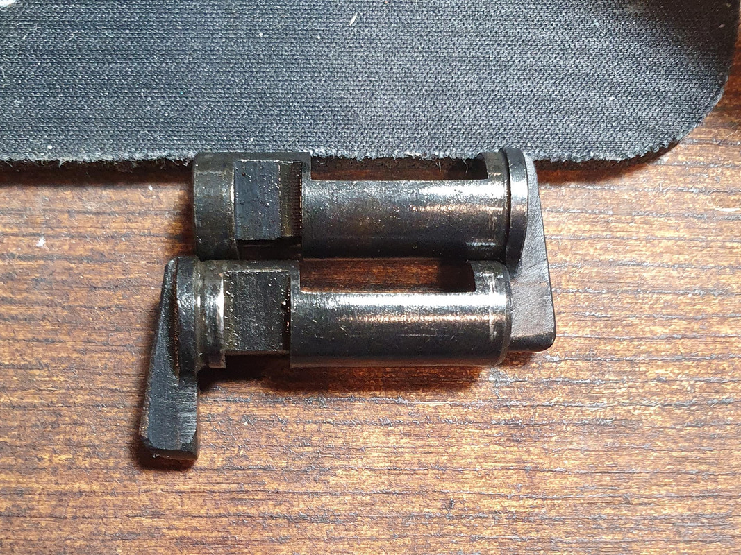

Anyone else is having issues trying to put LS (left side, original import) safety on new SE rifle?
It looks to me that problem is twofold.
First, as you can see recess for spring on RS is a bit shifted to the right, compared to LS safety.
Second, moon-shape recess on the receiver is on left side on earlier imports, while new import has recess on the right side.
As the result of this I was able to put RS safety on old import gun, but could not install correctly LS safety on new import rifle.
Slightly different placement of recess for spring.
LS safety on new import rifle is not secured by spring. One can't push spring into recess by pushing it.
Older import receiver recess on left side and no recess on right side.
New import (SE) recess in on the right side and no recess on the left.
