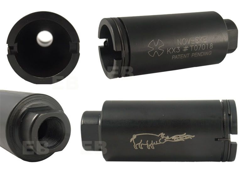

I don't want to derail this thread, but since we are on the topic of muzzle attachments. In your opinion, do you think a Noveske KX3 would work sufficiently to operate the T97 shorty? It is used successfully on AK74U and Krinkov's in other countries. I'm also wondering if a new booster/hider (like the Dlask one you posted pics of in the Vz58 thread) would make the shorty smoke less gas in my face? I know Dlask did the one that NEMO has and apparently it doesn't "smoke" now. I'm thinking the Noveske and the Dlask unit would be less "efficient" boosters as it is not their primary design function, and may work sufficiently to function the rifle properly, but still cause less smoke? I don't know if the booster is even the issue, just a thought in the dark.
Besides, the Noveske KX3 looks Bad A$$:redface:
Your thoughts are appreciated.
Pic of NEMO's gun (taken from his post in another thread)..I'm pretty sure this is Dlasks unit:
Pics of the Noveske. The slots in the front of the unit are supposed to be used to cut barbed wire. You put the barbed wire into the slots and pull the trigger!!! :D.

The brake on Nemo’s gun is a muzzle-raise compensator
and is good at what it is supposed to do,
but its intentional secondary effect is that of a recoil reducer.
Because of that, you will have even more gas (and smoke)
thrown in your face (from a very short barrel in a bullpup).
Originally that design is intended
and it is very effective for 14.5”-16.5” AR’s.
It was copied by few companies,
but people know mostly about PWS (Primary Weapons Systems)
who pimped that design very much,
but they didn’t invent it
(how they want to make people to believe).
Here’s a demo of the gun stability
(click the links at the bottom of this page):
http://www.rainierarms.com/?page=shop/detail&product_id=603
Noveske type FH’s will work very similar to your existing gas booster
as they are based on the same design.
They direct most of the gas forward,
but some gas will get back and slap you in your face.
Between yours and a Noveske, I am not sure if you will feel
a whole of a difference concerning that.
You can go ahead and buy a Noveske if you feel like
for the LCF and if you have nothing else to spend your money on.

thank you very much for your reply, as usual it is very informative. I'm not sure I explained my "gas" issue clearly. Gas probably isn't the right term. Maybe the better term to use would be "smoke". The muzzle blast is quite a thrill and all but that's not what is bothering me. I'm not getting slapped in the face as it where, with gas.
After I shoot (one shot or five or ten) smoke drifts up around the charging handle and sometimes it gets into my eyes (even though I wear safety glasses) or I breath in a good bit of it. I get the smoke after the rifle has cycled the action and I'm waiting to take another shot. If I fire off a quick string of two or three, or ten, it's after I finish the string that I get the smoke. If I fire slowly enough I get it after every shot.
The smoke is not so bad that the gun is uncomfortable to fire. It only gets in my eye occasionally or if I get a bit of wind in the face.
Here's a small edited video clip from my very first range session with the rifle. The version shown here is right after firing five quick rounds. (pay no attention to the audio I was trying to say "just so you can see steam coming off the barrel" but it sounds like I'm speaking a different language LOL:redface:.
If you look closely you can see smoke coming from two places:
1) the muzzle
2) from around the charging handle under the hand guard.
The only thing I can think that is happening is that after a round is fired perhaps "smoke" (not gas) is collecting in the gas booster and somehow getting back around the piston and up around the charging handle. It was my hope that maybe another Flash Hider/Booster may alleviate the issue. I have no problem waiting for the Canadian made version of the Noveske and I'm not so much concerned with looks as I am with improving the rifle.
EDIT: For those reading this thread...Once again as far as I know this issue is only with the Type 97 Shorty....the Smoke issue does not happen with the regular barrel T97 version.

It seems that you have to live with a measure of that. On short barrels, the powder is still burning as the bullet leaves the muzzle.
Thanks Deck. Nemo has told me that a friend of his cured the problem. That's why I thought maybe it may have to do with the muzzle attachments. But I can't get any more info than that:(.
