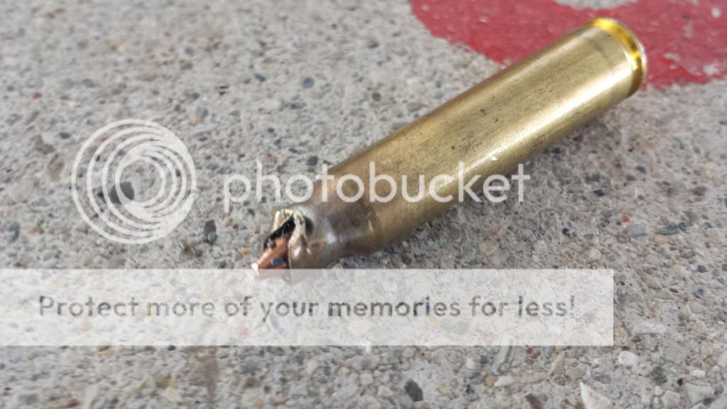

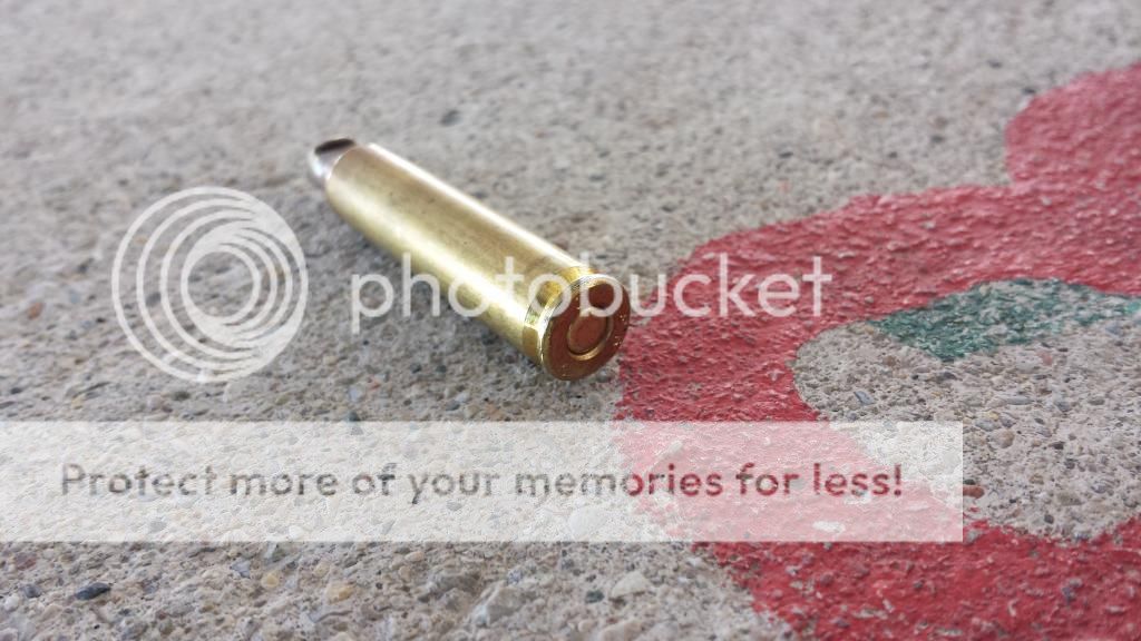

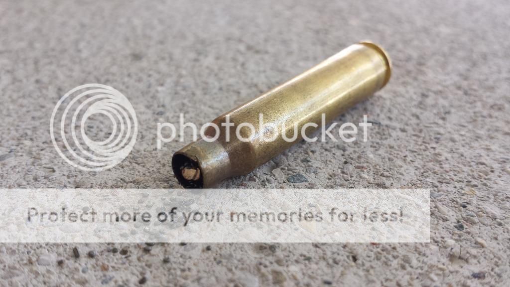

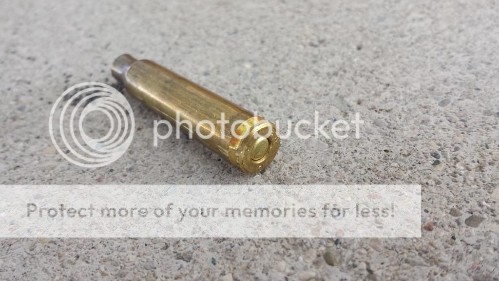

Hello Everyone,
The other day I took my newly acquired Type 97 to the range and shot about 50rnds. Out of that I had 2 FTF and about 5 more Failure to chamber properly.
Below are pictures of the 2 FTF's. I have no idea what could have caused this and want to reach out to the community for your expertise. The ammo was Norinco .223 from 93. Never had an issue with this ammo in any other gun so I dont think it's the ammo.... but what do I know...
The 1 FTF was from an LAR15 magazine and the other was from an XCR pistol mag. The other 5 rounds that would not chamber properly are from a Gen 2 PMAG.
As you can also see... the primer has not been struck. That also happened with the failure to chamber properly.
Thank you for your help.
Some people have reported issues with the norc ammo. Also reports with the grey LAR mags doing this. My rifle has been fine with all mags I've tried. You might wanna try some different ammo if it still persists with all mags you might need to file feed ramp. Just try this insert an empty mag and pull bolt back so you can see in chamber. Now pull down and back on mag and see if the top front of the mag comes down a lot. Mine does some but still feeds properly. You should be able to see where bullets have been rubbing. That's where you MIGHT need to file a tiny bit.
Have you not used the mag that came with the T97?
If you do without any problems, that would certainly point to the mags you are using.
The picture would indicate that the round impacted the feed ramp & got nowhere near the chamber.

Yea I did some testing and it seems that at least with my XCR pistol mags, the bullet misses the chamber and hits the sides. I'm actually in the KW area and go to the Elmira range. Would like to meet another Type 97 owner who knows more about the gun than I do. Shoot me a PM of when we might be able to arrange something :)

Insert the mag with some dummy rounds and run the bolt ahead slowly. The round will be hitting below the feed ramp due to the mag seating too low in the mag well.
File the feed ramp downwards until the round is being guided upwards as the bolt is closed.
