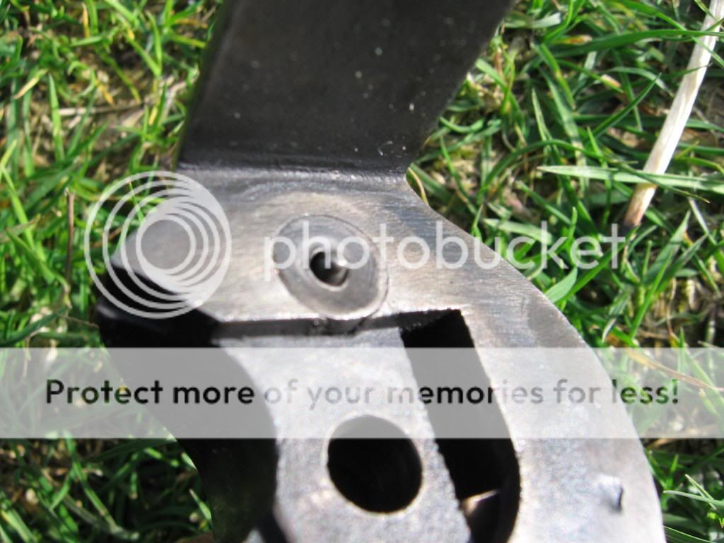

Here are the images:

If you want to identify the issue and then fix it yourself you'll want to have some way of measuring and modifying the pin. A picture won't do us any good. We all know what the pin looks like sticking out of the recoil shield liner. Instead you need to have a way to measure the protrusion to within a thou then find out what it SHOULD be and then work the pin down shorter and re-profile and polish the nose. A file is fine for the initial shortening. But then you'll want to CAREFULLY round the nose of the pin evenly and accurately to re-produce the shape.
It's also possible that your FP has the right protrusion but perhaps it's too sharp or too blunt with sharp edges. As shown in Skinny's photo you want it to be neatly rounded and polished.

So, I have 0.005" to give on the firing pin protrusion before it's out of spec, and mine does look a little rough compared to Skinny's. I think I'll go at it with a strop and round it off and see where that gets me.
That would be a reasonable start. It's best to sneak up on the issue by starting with the least invasive action like you're doing. Especially if you find that it has a sharpness to it compared to Skinny's picture.
My own hammers on my Pietta and S&W guns that have hammer mounted firing pins are even a little more rounded than Skinny's.
