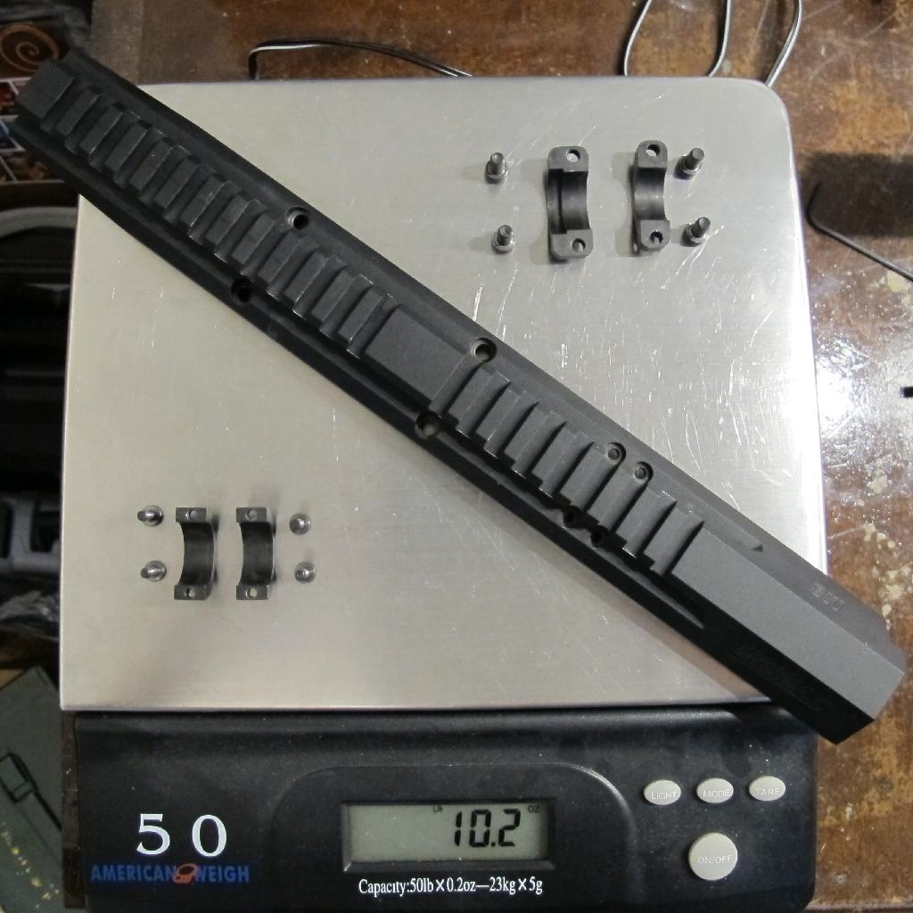

Here are a few notes to consider that are not available on the original product description page.
1. our compression methodology and proprietary bracket design ensures a secure, uniform fitment to m14/m1a barrels that may vary in dimension - think of our bracket design "strapping" the barrel, as opposed to "bracketing" it.
2. We use a total of 14 fasteners and 3 proprietary steel barrel "straps" to deliver perfect fitment of rail to barrel (in our opinion, other products do not employ the same standard of precision).
3. the SHG is as low as the top forward receiver flat at the barrel ring, yet it still has an opening at the side for 10 and 2 o'clock 4" picatinny rails for optics or otherwise
4. Blackfeather customers are afforded a a significantly stronger connection of rail to rifle (a fourth leg if you will) due to the fact that the rail is inletted precisely for the Blackfeather RS's adjustable oprod guide
5. The M14.ca SHG is approximately 3.55oz. lighter than any competing, ultra low aluminum rail systems (all components included in weight comparison).

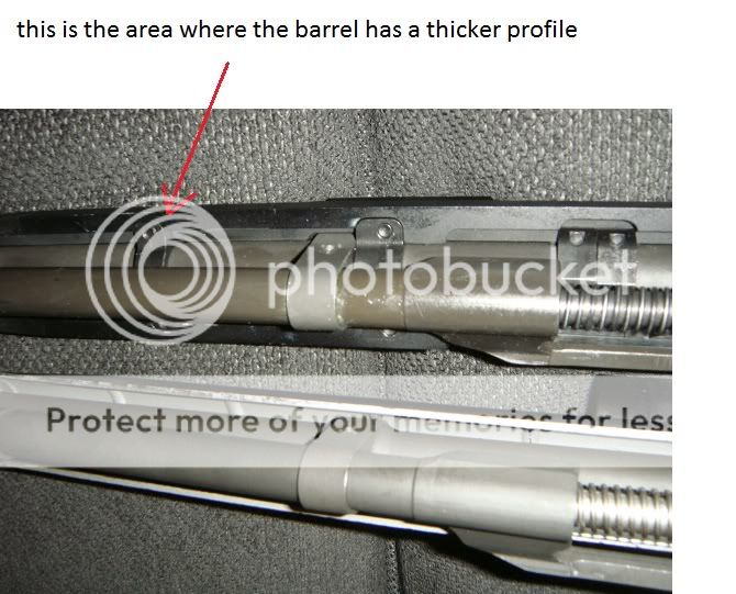

I put an M8 on my shorty and really like it . Some of the material on the Ultimak had to be removed as the barrel profile is different compared to the 22 inch versions .
It was an easy fix though .
The lighter colored area is where material was removed to get my Shorty to fit correctly.
This clamp has to sit flush as shown in the pic .( 50calshooter supplied the pic but he is gone now )
