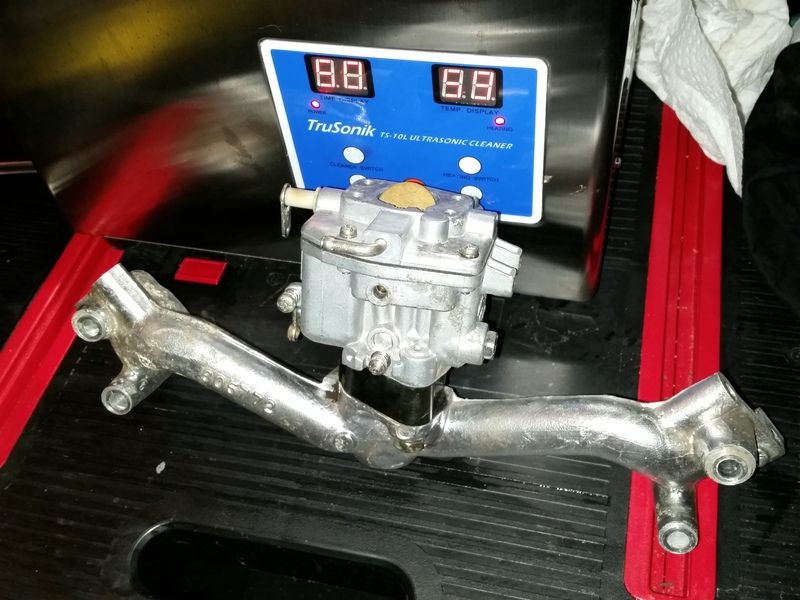

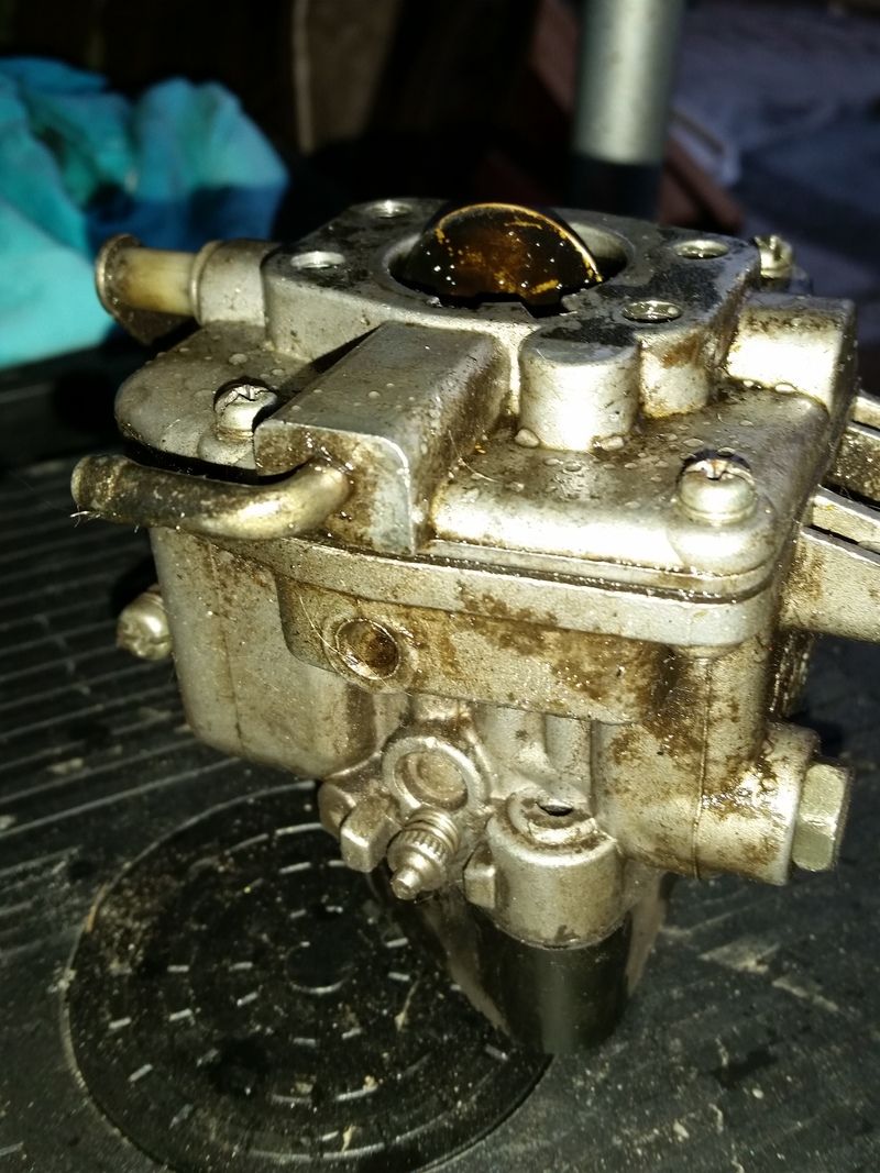

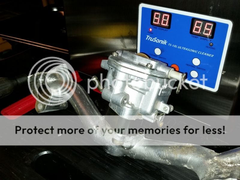

Here are before and after pictures of the carburetor off of my Argo. This is the result of a 15 minute cycle in water and Simple Green at 50 degrees.
