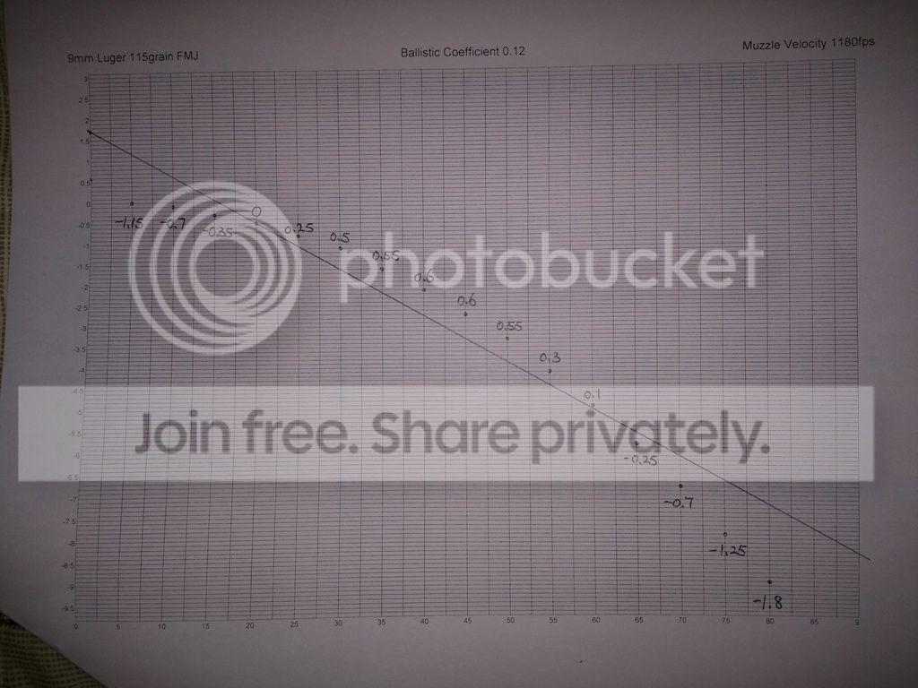

-You might have to compensate for the point of aim at a closer distance, because the sight sit high above the bore. In my case, my Burris (measure from the center of the glass) sits 1.7 inch from the center of the bore. Sighted in at 20 yards will make the trajectory pretty much flat out to 75 yards. but within 20 yards, or even close at 7 yards, I have have to hold above my point of aim.
(See the attached CHART below) My line of sight in relationship to the bullet impact point.
