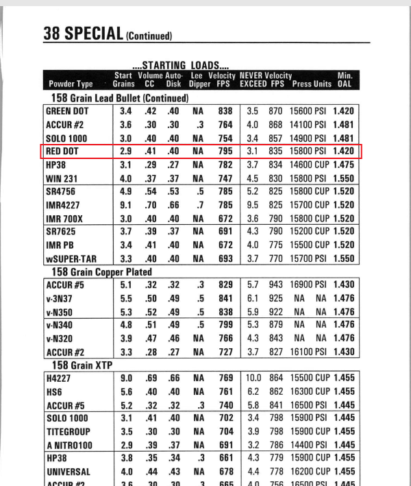

I've gotten back into shooting my revolver. S&W 19-5 357. Been loading up a bunch of 38 special loads. Using Lee TL 158gr round nose bullets, federal small pistol and Red Dot. 2.6gr and 3gr. Loads have excellent accuracy and low recoil. But i am getting alot of un burnt powder.
I shot about 250 last weekend and unloaded the casings straight into a Ziploc bag. There was a bit more than a teaspoon of powder in the bottom of the bag. With the red dots in it.
I tried a bit more crimp. Still getting it.
Thoughts?
Your powder charge is too low. At 2.6gr you 0.3gr below the minimum charge listed in "Modern Reloading #2". Low pressure = a teaspoon full of unburnt powder. Keep the charge around the 3.1gr mark.
Change to Win 231 start 3.1 grains and federal primers and 148 gr hbwc .357 cases and it just may surprise you:)
I was using the load data for a 148gr bullet. As I weighed these bullets and they came out at 146gr on average. 148gr says 2.4-2.5gr. The 158 is like you said 2.9-3.1.
