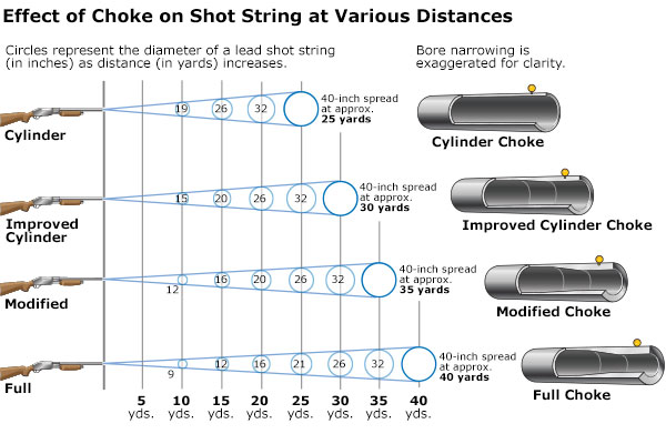

This image should help you understand how it controls or restricts the number of pellets
