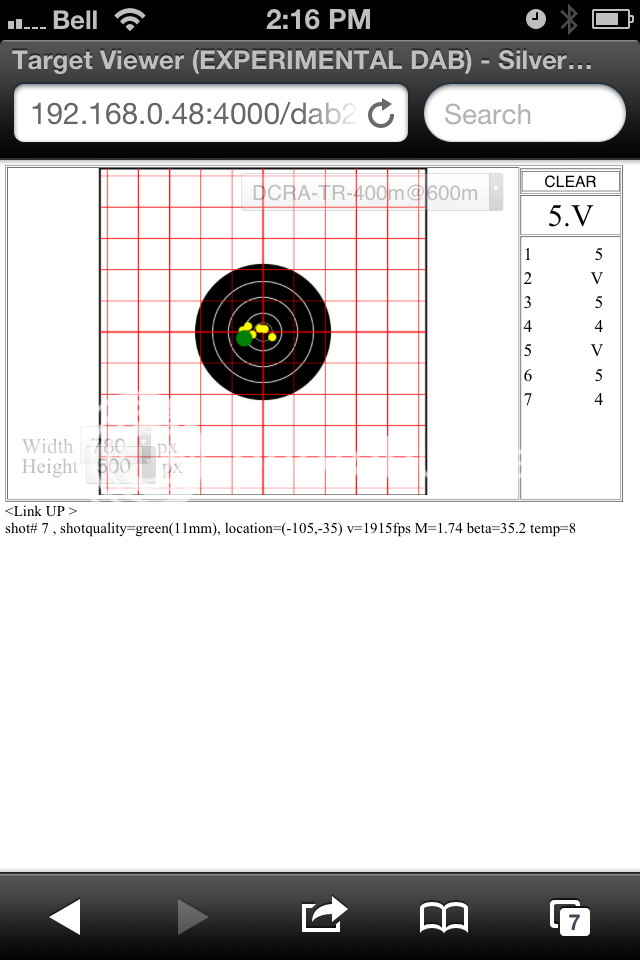

You know, that does tend to help, although the rifle did produce this group, in spite of the substandard mounting job. It does drive home my point about the rings being snug on the rail! For refrence, those are 1 moa grids.
