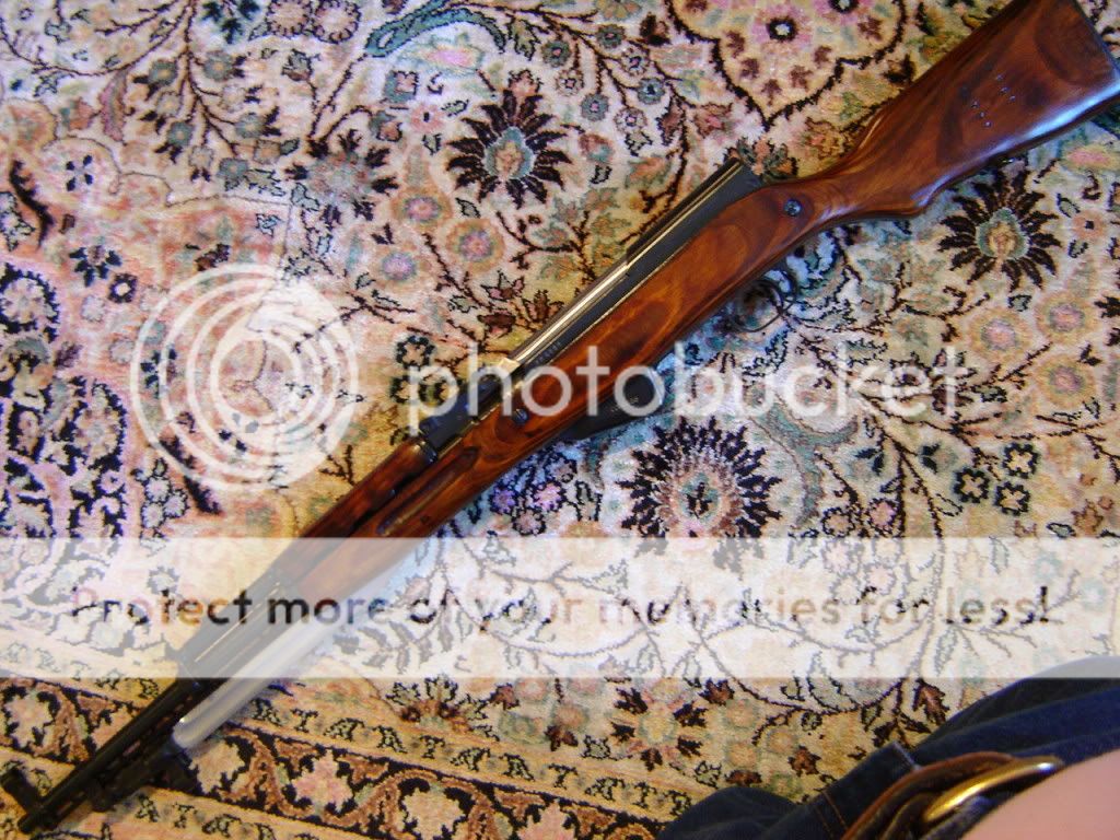

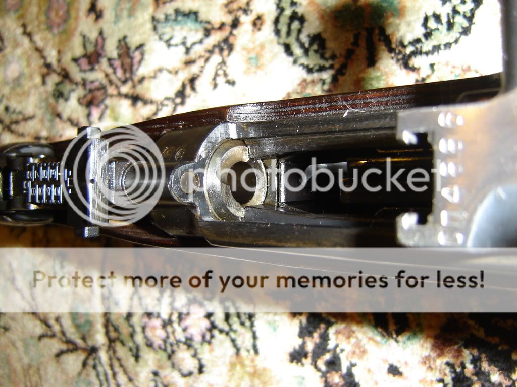

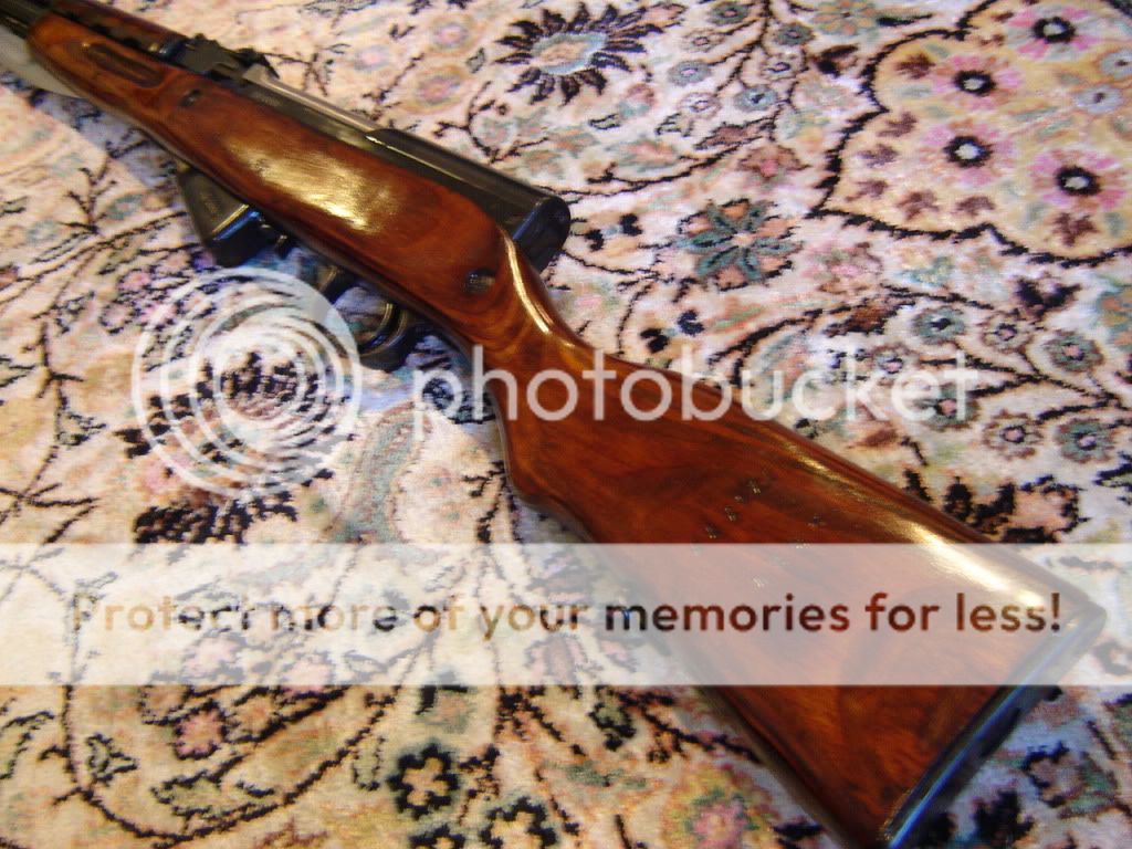

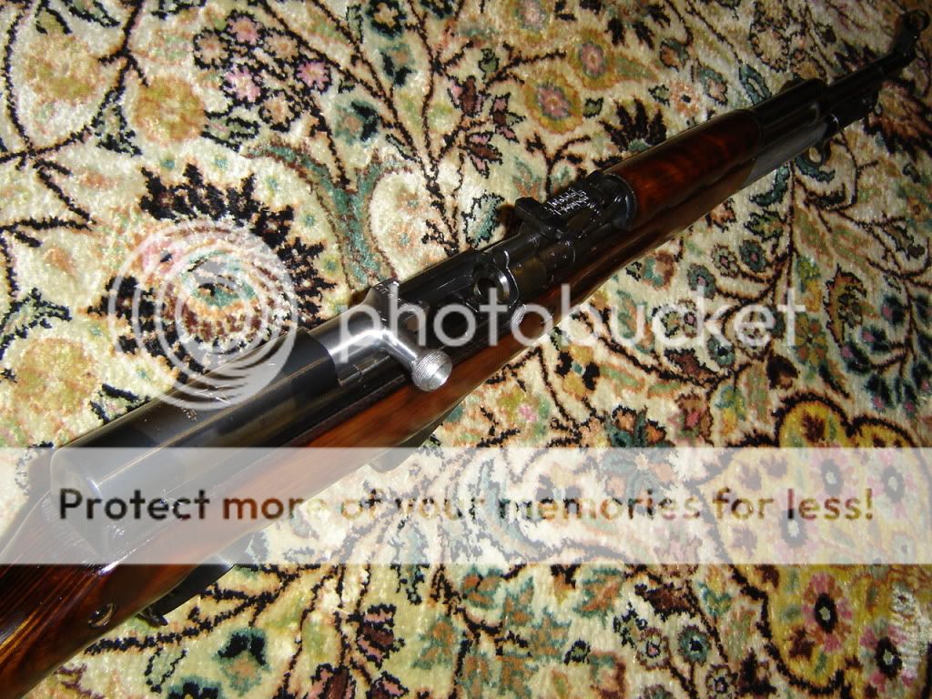

How can I really know if my SKS is "un-issued"- therefore it is New-Old-Stock and unfired except perhaps at the manufacturer for function test? Please see pictures of my 55 below. What can you say about it?
By the mainstream description, if it has no factory refurb marks on the receiver cover, it's un-issued. I have three of them, each from a different years. I am hoping to get one from each year and each factory to complete my collection. I have a long way to go.
In reality, the above statement is as valid is used TP. There is no way you can prove each part of the SKS is a factory un-issued production part, no matter how savvy you are at collecting. I have never been to the factory to pick my rifle before it was exported. I doubt anyone else here has either.
Here is a little piece of reality for you. Anyone can order a receiver cover from the U.S. from surplus with no factory refurb issue marks on it dated, slap it on a refurb, and cry UN-ISSUED. But for the sake of discussion here and how SKS's are graded in Canada, follow the FAQ. Take it with a grain of salt.
Un-issued rifles have basic identifiers:
1. No refurb marking on the receiver cover (diamond or square)
2. Every part on the rifle has NO movement marks. (unless someone here in Canada dinked with it before it was boxed up)
3. All matching numbers. Dead giveaway it's not an un-issued is if the serial # on the stock is X'ed out and the serial # is put on it again.
4. Bayo marks on the barrel.
That's the "simple" way to check.
To be honest, even the "un-issued" ones here are not "un-issued" because the GPNS made us pin them to five and the magazine has been "modified" so technically it's no longer un-issued. But again, use the FAQ as a guide.

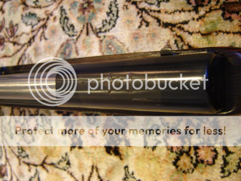

I read the SKS FAQ sticky and there is no mention or explanation of the significance of the "check" or shallow V-mark on the receiver of my 55 Tula, as shown in the previous pictures.
Has anyone seen this V-mark or anything similar to it? Can somebody explain what this mark is for?
A few things about your gun. Seeing as I can't see the serial number on the receiver,I'll take it as not being a letter series. The stock is on it's second rifle. The handguard is hardwood,not laminate. Now the rest of the gun looks to be in pretty good shape. So it could be one of those excellent condition rifles that was caught up in nothing more than a stock swap,and was subsequently refurb marked. I've seen unissueds get caught in a refurb bunch,and get marked but are still in the original stock. The popular thinking is that they were marked to show someone checked them over.
WB, It sure looks in excellent shape, like new even, were it not for the stock being forced matched. The shallow-V mark on the receiver still bothers me. Deanner aand DAR701 seem to think it is a poorly struck refurb diamond, but the mark looks like a deliberate strike without the other half of the diamond. What can you say about this?
i'll have to side with deanner and DAR701 .
also as i mentioned in my sticky that some refurb work is so good that its hard to tell its been refurb .
Sorry,Easy. But I have to agree with the rest of the gang. It's a half of a refurb diamond. I've had ones like your's and black bolt ones with the same half struck marking on them. I've also seen partly struck squares.
Thank you, Curtton and Woodbeef, that's the definitive response I was waiting for. I really appreciate your help.
BTW, got a 51 and 52 coming home this week. They looked good at Lever when I picked them out but couldn't bring them home last Saturday because the firearms center was closed. No diamonds, squares, partial or complete. Can't remember which one, but one had matching stock.
Will post pictures at earliest opportunity for your expert opinions.
easy: i forgot to say according to your pic , you done well , considering there was some pretty crappy ones there .
