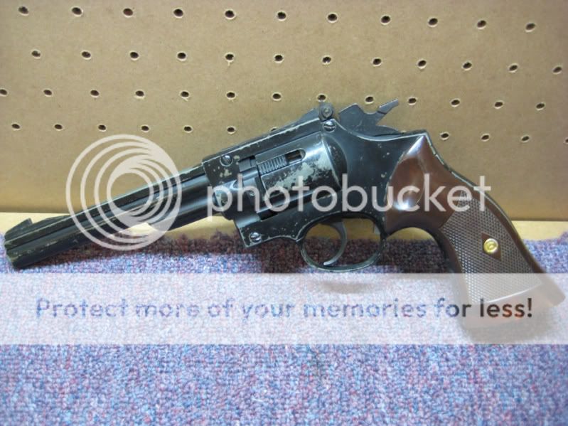

This revolver belonged to my father, and I've been wondering about it; make, model, where to find a manual, etc.
Hopefully someone here has seen one of these before, and can tell me something about it.
I've shot snowshoe hares with one as a kid in .22 cal......................quite accurate as I recall......................Harold
Coupla things to watch.
Look at the valve body. If it's grey/white color, it's die cast Zinc. If it's yellow, it's brass. The zinc ones are a bit sensitive to having the threads torqued too much, and will strip out if not handled with some care. The brass valve bodies are not readily available.
Look at where the hammer hits the valve. Does it hit the valve directly, or does it strike a transfer bar. The transfer bar eats a tiny bit of the energy of the hammer strike, and can result in a less powerful gun when all is as good as it gets. The direct strike valved models can be tuned a bit higher than the transfer bar ones.
But the real point is to point out that there are a couple different variants during the production run, and to watch for the changes, as they may cause parts to not be correct, depending on what you are looking for, if anything.
The cylinder itself may be metal or plastic, IIRC. They can be adjusted to give the best timing possible (alignment of the cylinder and barrel) and this allows a little better power.
Mac1 Airguns site has a bit to say about the Crosman Revolvers.
I have a couple around. Fun to shoot, if you don't mind the cost of powerlets.
The 22 pellets will lay some pretty good smack on a pop bottle or can, too.

I still shoot the 38T I got second hand in '67,it is a keeper. Your's looks like an early model--long rear sight, metal cylinder, no transfer bar, and wonder of wonders, an unbroken left grip.

Thanks for all the replies guys.
Tiriaq, Gab: I was able to locate the correct manual at Crosman's site. Thanks for pointing me there.
Threemorewishes: I may have to look for a re-seal kit, as the o-ring the seals the powerlet is a little chewed up.
Gandalfe: Too true. I have a newer 357 model as well, and the difference between the two is night and day.
Trevj: Thanks for the heads up. My valve body appears to be zinc, the hammer hits the valve directly, and the cylinder is metal; apparently they switched to plastic in later years. I’ll be careful if I ever have to mess with the valve body. I’ll have to check that Mac 1 site out.
Waba: Good eye, looking at the information I have thanks to those here, I believe it is. The grip is in decent shape, but the little cups that mate to the knobs on the frame are broken, otherwise it appears to be in good working order.
