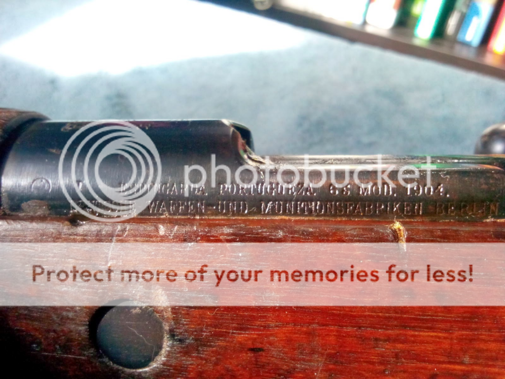

Unknown Portuguese Mauser made in Berlin.
7.62xfun
16   0   0
I traded a guy a cooey .410 for this today. Bayonet seems to fit wrong and it's not 6.5 cal. I'll post some pictures and if you need more let me knowimage.jpgimage.jpgimage.jpgimage.jpgimage.jpgimage.jpg

Model 1904 Mauser-Vergueiro. Original round was 6.5 X 58 Rimless.
Do not take the bolt apart! It's supposed to be a b*tch to re-assemble. Some collectors joke that you need three hands to get it back together. It's essentially a Model 1898 Mauser with a different Mannlicher-Schonauer bolt.
Its said that it difficult to find these rifles in good condition. Good score, but I don't think you'll be shooting it anytime soon ( unless it came with ammunition )
This is a Portuguese Mauser-Vergueiro m/1904/39 Rifle in 8x57mm, it was converted from 6.5x58mm and the Bayonet is not original to this rifle, it looks like a 1908 Brazilian Mauser bayonet. You got a good deal on the trade! Hopefully the bore is not rusty like the action.
That is a Portuguese M1904/39 Mauser-Vergueiro. Caliber is 8mm Mauser. That example is a bit worn but they are very nice rifles (the one I have is one of my favourite guns). The bayonet there is wrong for the rifle, I think it might be a Brazilian Mauser bayonet but I am not sure. Is it matching numbers (be sure to check the safety as most are different numbered)?Here is a picture of mine with the proper bayonet beside it (photo wasn't taken by me only using it as it is the only one I have readily available).

The model 1904/39 should have shorter bbl (23.5") as opposed to the longer bbls of the unaltered 1904(29").
One discrepancy that I can see also is that the front sight doesn't have 'ears' ( although they may have been removed).
I'd go with the 8mm theory anyhow; as it's got the extra reinforcing bolt for the 8mm rd. How high (numerically) does the rear sight go?

Here is a photo of the side of mine (once again not my photo). No crosses over the 6.5 but a good key to tell if it has been converted as well is the fact the 'gas vent' has been drilled into the side of the receiver (on mine it was still covered in cosmoline at this point but you can see where it is). The changes from the 1904 to the 1904/39 were shorter barrel (brand new 8mm Mauser barrel), shortened stock, sight ramp partially ground to accommodate the new round, front sight ears added (I can see the hole drilled for the screw which would have held the front sight ears in place in the one above someone likely removed it at some point in time), and the gas vent drilled into the side of the receiver. I also am going to edit my estimated value to be 250-300$ for the rifle as since that part is missing it will lower the value.

First off, it isn't a 98 clone.
Secondly, it has the small cut out at the top of the receiver ring to accept the Spitzer type bullets of the 8x57. The bayo in the pic is a 1908 Brazilian and is worth more than the 410 by itself.
This isn't the first 1904/39 I've seen without front sight protectors.
If you're lucky, it still has its original trigger guard/ floor plate. Many of them were stripped off for sporter builds on 98 actions They fit perfectly and have latched, swinging floor plates.

From your OP, the barrel on that rifle looks to be a bit longer than usual for a converted Vergeuiro. The front band isn't right either. Are you sure it isn't still in its original chambering????
If it is 8mm, a 6.5 bullet will slip right in. If either of your Arisakas are type 38s, the bullet from one of those will be close enough to tell if it's 8mm or not. Those missing sight ears are telling us something here. The original barrels didn't have them

Yours looks shorter so I am leaning towards refurbishment to match up with the Kar98ks that were being purchased in the late 30s. I am also not a fan of dropping rounds in and seeing if the bolt will close as there could be other issues with the chamber or bolt that you wouldn't see. Unless you are certain of the calibre, I recommend a trip to a qualified gunsmith who can determine the calibre and anything else out of the ordinary.
Your bayonet is also incorrect and is from a 1908 Brazilian rifle. It is in rough shape by the looks of it so my guess would be $50-75 roughly for value.
Edit: Did anyone else notice the "hole" that is just forward of the DWM address stamp on the OP's rifle ? Could she be a dewatt ?
This doesn't look normal from other 1904s I have seen but I have never personally owned an example so I can't say for sure.

The hole is a gas vent (I don't know if it would have worked or not) they drilled when they were converted to 8mm Mauser. So far everything provided adds up to a 1904/39 as it has all the ticks in the box for the conversion, its just missing the front sight hood.
The hole is normal for the 1904/39. As mentioned, a vent hole.
