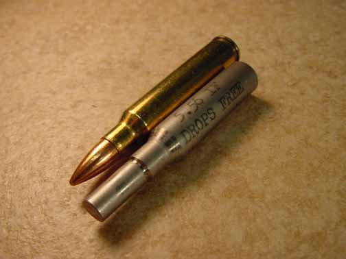

Ideally, to check the freebore/throat angle you need a gauge that looks like this

The only difference between 223 and 556 is the length of the throat. A headspace gauge datums on the case shoulder and never comes anywhere near the throat. The only way to confirm a 556 chamber is the cast the thing and include the throat. Then you need a shadow graph to compare the casting to a reamer. I'd bet only 1 or 2 smiths in the entire country have that kind of equipment.
