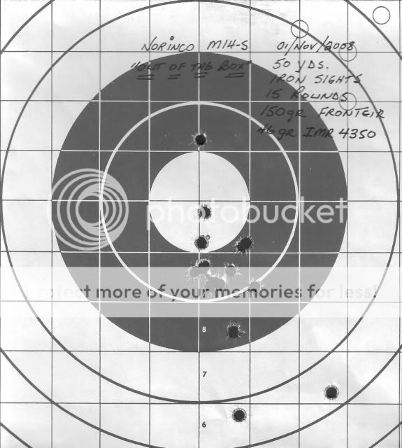

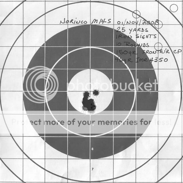

Awesome rifle!
Out of the box Norinco M14-S (Stripped, cleaned in dishwasher, reassembled)
I DID NOT TOUCH THE SIGHTS..!
46gr IMR4350
150gr Fronteir copper plated flat nosed funky bullet
Seated to 2.460" with slight crimp
25yds iron sights 10 shot group:
50yds iron sights 15 shot group:
The two shots in the 6 ring was my fault... I "breathed" as I squeezed off the shot.
Rifle operated flawlessly, recoil is very tame. Bullets fed without problem. This rifle is a "keeper". Didn't shoot at 100 yds cause I can't see squat passed 50 yds without a scope.
omg. thats a 50yard target?
i wont buy those bullets ever.
That's a fifty yard target with iron sights and poor eyesight.
I'd want to see what some groups looked like with both decent load development, and scope sights, before I would write off these bullets. They are not exactly sold as match ammo, either.

Can you say... OVER RE-ACTION???
Nothing wrong with Frontier bullets as long as you realize they are not match bullets. Enjoy the rifle & enjoy your reloading experience ( I find it a soothing pastime in a sometime frustrating way if that makes any sense).

Griffoneur, that looks pretty decent.
Your 25-yard group is much smaller than your 50-yard group, way less than half the size. This is probably not the rifle and ammo, but probably your sight picture. You might find that if you used a target with a larger aiming black, that your sight picture would improve, and that you would be able to get better groups.
Your 25-yard target shows that you, your eyes, your sights, your rifle and your ammo are capable of putting ten out of ten shots into about 3/4" at 25 yards. I would expect that you would therefore be able to shoot a group about four times as large as that at 100 yards (four times the distance), which would be 3", if you have everything else working properly (in particular, an aiming black large enough to give you a good 100y sight picture).
3" for ten shots at 100 yards is, in my opinion, pretty darn good. I don't seem to be able to do any better than 5" groups at 100y using my M1 Garand, even using true match ammunition.

The 50 yards group is about as far as I can see without a scope. And 50 yards is pushing my eyes to the limit. Any serious long range shooting I do with a scope.
I don't want to scope the M-14. A proper mount is $200+ and to me is totally useless as a hunting rifle as it is just too damn heavy to hump around.
The Fronteir bullets are not match quality, not by a long shot. But for "plinking" they work fine. If you want to go and shoot some dirt pigs, these will do the job nicely.
Griff, to shoot farther just increase the size of the aiming black, that way your sight picture remains unchanged. When shooting from a rested position, try a center hold rather than a 6 o'clock hold. With a center hold, if the light changes, you are not constantly trying to see if the top of the post is against the bottom of the black. Regardless of range, with a center hold the center black should be equal to the width of your front post. This simplifies your sight picture tremendously. Note that you are not having any difficulty with the horizontal spread, an adjustment of 1 minute left and your group would split the center line nicely, but you appear to be fighting with the vertical.
Conversely, if shooting off hand, try a sub-6 hold, allowing a space about half way between the bottom of the target and the bottom of the black as the distance from the top of your post to the bottom of the black. Once that sight picture is required all you have to do is increase pressure on the trigger when the center of the post is in line with the center of the black, without concern for correcting the elevation. It sounds illogical, but it works.
