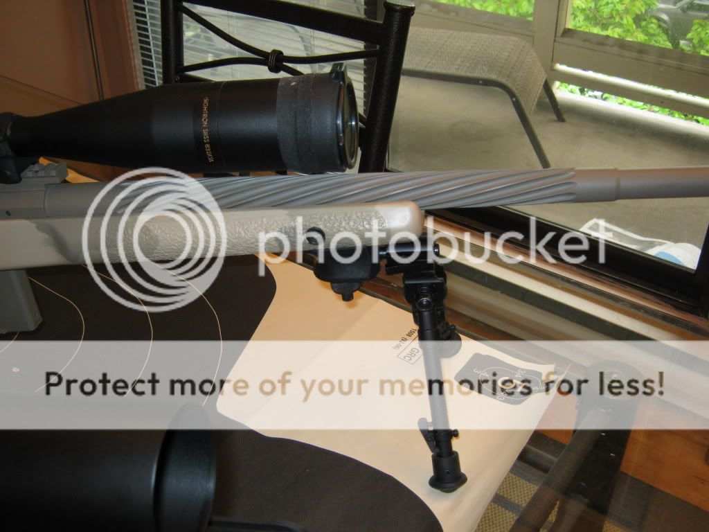

Harris
The first bipod up for review is the Harris pictured below on my Remington AICS 2.0 combo.
This is the 6-9 swivel model and while I am at it I strongly recommend getting the swivel version - it far surpasses the regular versions and is worth the extra money. I also recommend getting the little handle ( I think its' proper name is the 'S lock' ) pictured that replaces the swivel nut as it makes for far easier operation in the field and is certainly worth an additional $25 or so that they sell for.
Harris bipods are made in the USA and are the best selling bipods out there and, like most poular products, are copied with knock offs selling for quite a bit less than the original which, locally, retails for about $130-140 ( the model being reviewed). Some of the copies like the one made for Shooters Ridge are OK but some of the really cheap ones found on Ebay may be ok for air rifles and .22's but I wouldn't trust them on centrefire rifles.
The advantages of a Harris are that it is easy to install, it deploys very fast ( i.e. you can get the legs in place very quick ) and relative to other well-known brands it is relatively inexpensive. Harris' are also light weight and fold close to the stock which means you are less likely to snag the folded legs when moving through bush or similar terrain. While there isn't much to really dislike about a Harris I do find them less stable than some other styles and they do have a tendency to bounce from shot to shot especially when deployed on a hard surface. Having said that they are tried and true and are used by many shooters worldwide.
Versapod
The Versapod - pictured below attached to my PGW Coyote - is a substantially 'beefier' and a more expensive option than the Harris
Manufactured in the USA the Versapod is similar to the old Parker Hale and is a popular choice amongst tactical shooters but not nearly as so as the Harris. A teensy bit more difficult to install than the Harris, the Versapod is still easy to attach to a rifle and offers some advantages over the Harris but the advantages come at a price. I purchased the 'Battle Pack' and paid over $300 which is significantly more than the Harris but for the money you get 3 sets of legs; the usual rubber feet as well as legs with skids on them and ones with claws or, as Versapod calls them, Raptor feet :rolleyes: and a molle pouch to hold them all together. The Versapod swivels and the legs are notched ( I always prefer notched legs - if you get a Harris which comes with and without notches I recommend going for the notched version ) . When installed it feels very solid and it is easy to 'load' the bipod if that is your preference. Overall I feel the Versapod is more stable piece of kit than the Harris and - for those that consider this to be important - it certainly looks more aggressive or 'Tacti-cool'
Besides the price being more than the Harris the only other downside to the Versapod is that it doesn't deploy so quickly but the difference is so small as to be, IMO, quite negligible. If ounces count the Versapod is also a little heavier than the Harris but not so much as to make a noticeable difference to the rifles balance. Is it worth the additional cost over the Harris ? In my view, yes it is but as with anything on the internet your mileage may vary.

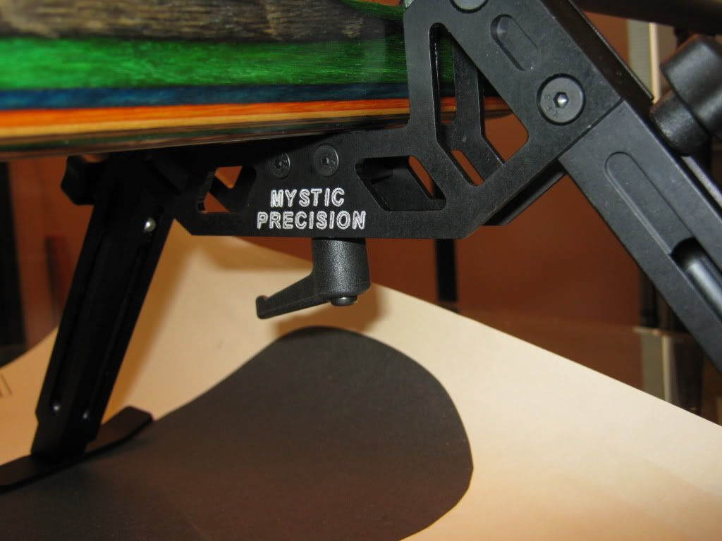

Mystic Precision MPOD
Pictured below attached to my RPA custom F/TR rifle the MPOD is a new entry into the marketplace
I was fortunate last year to acquire a pre-production model from Jerry and, after using it for a while, I provided him with my feedback. Eventually I passed that particular bipod onto a friend of mine who still uses it and is happy with it. When I decided to write this review I purchased a new MPOD from Jerry as the new production incorporates some improvements over the pre-production model and I wanted to see how the finished product looked and felt. The retail cost of the new MPOD is $200 plus tax and shipping etc.
As always, dealing with Jerry is great - his customer service is amongst the very best and the MPOD arrived as fast as the fine folks at Canada Post could trot it over to me. The MPOD arrives unassembled and the included assembly instructions are clearly written and easy to follow but while that is the case please do not assume that you can take the package to the field or range, quickly install your new bipod and 5 minutes later be shooting as some fine tuning may be required. Mine needed a few minutes with a file to get the parts to fit properly together - while the instructions say that this may be necessary I was, nevertheless, a bit disappointed to find that I needed to do so. Maybe I am being overly picky but I am calling it as I see it.
When assembled the MPOD is very solid and attached to my RPA ( which uses the American rail ) with ease but, sadly, does not attach to my other F-Class rifle nor my Anschutz .22 both of which use the European rail. At the time of writing I don't know if Mystic offers a choice of attachments.
Where the MPOD really shines in in the use - it is a very stable platform from which to shoot feeling much more solid than even the Versapod and yet it is still nice and light (12.8 oz). It doesn't move about and I think people will notice a tightening up of groups when moving to the MPOD from a Harris or similar. It slides on and off the rifle with ease and is fully adjustable to allow for uneven terrain etc. For those with a particular need I believe it is possible at the time of ordering to customize the MPOD to allow for wider forends etc which is nice to know.
Overall I am very impressed with the MPOD - light, strong and very stable when shooting.

We are happy to offer custom sized lugs to fit smaller then standard rails.
The sizing of the lug was tested on a wide range of rails and stocks including "Anschutz" rails.
Seems some are smaller then others.
Appreciate the review and let me know on the sizing...
Jerry

Problem solved. The T slot rail fits on the dual studs inserts or you just drill another hole and bolt in place.
We are thinking about a fine adjust wheel but for the most part, once set up, the fine adjustment is just as easily served with the rear bag.
The legs are also easy to move in small increments. Not as convenient but saving a few lbs has its compromises.

Yes, we sell the T slot rail and other ways to mount the MPOD to rifles.
At this time, the lug is set up to fit on both Euro and US style T slot rails,
Then we have the Swivel stud adaptor (need 2 holes in the forend - dual stud inserts or just drill a 2nd hole) - pic above.
Pic rail mount so you can use the MPOD on an AR or similar rail.
Remple adaptor so for those that need to shave off a few lbs can just use the mounting plates already in their stocks.
We are also making the 3" wide plates and the 1 5/8" wide sporter plates. Essentially, there isn't a rifle that the MPOD cannot be mounted to now.
