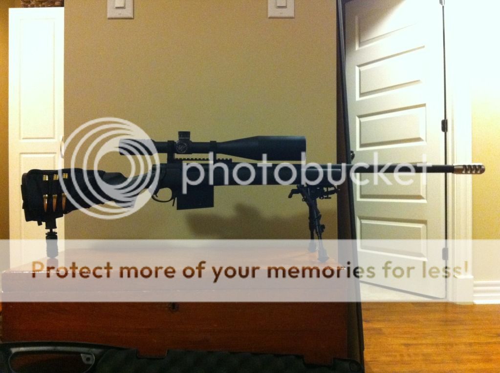

I have been doing some work to my Remington 700P 338 Lapua Magnum and I thought I would post some of the work I have done.

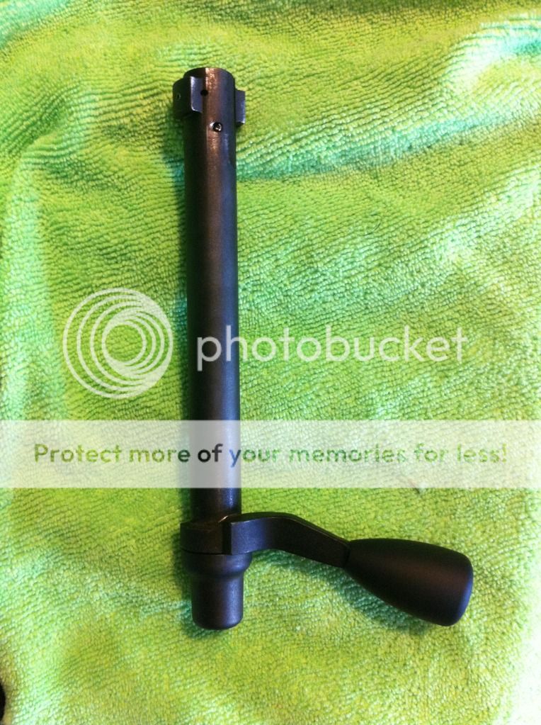

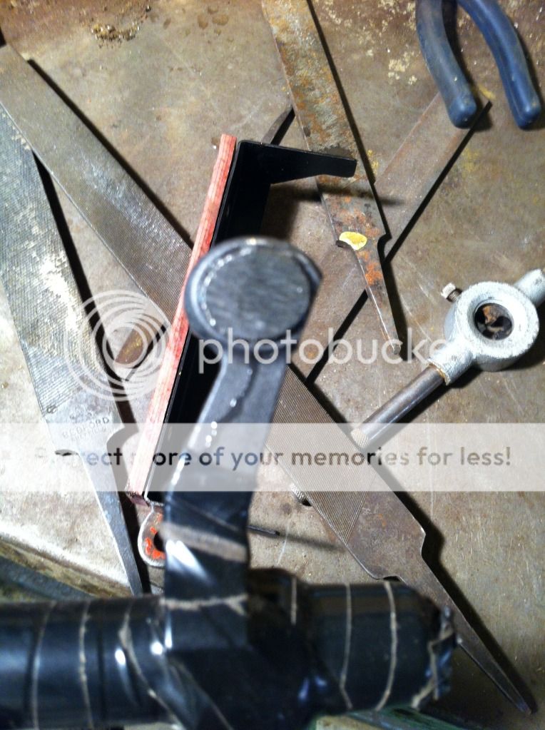

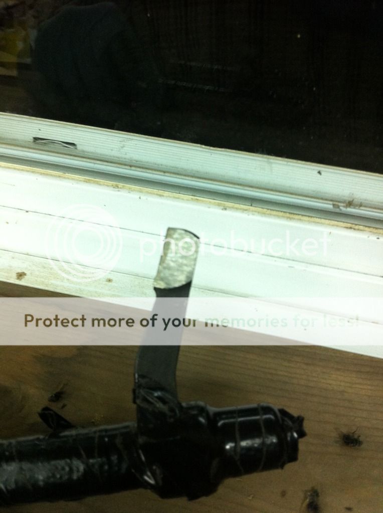

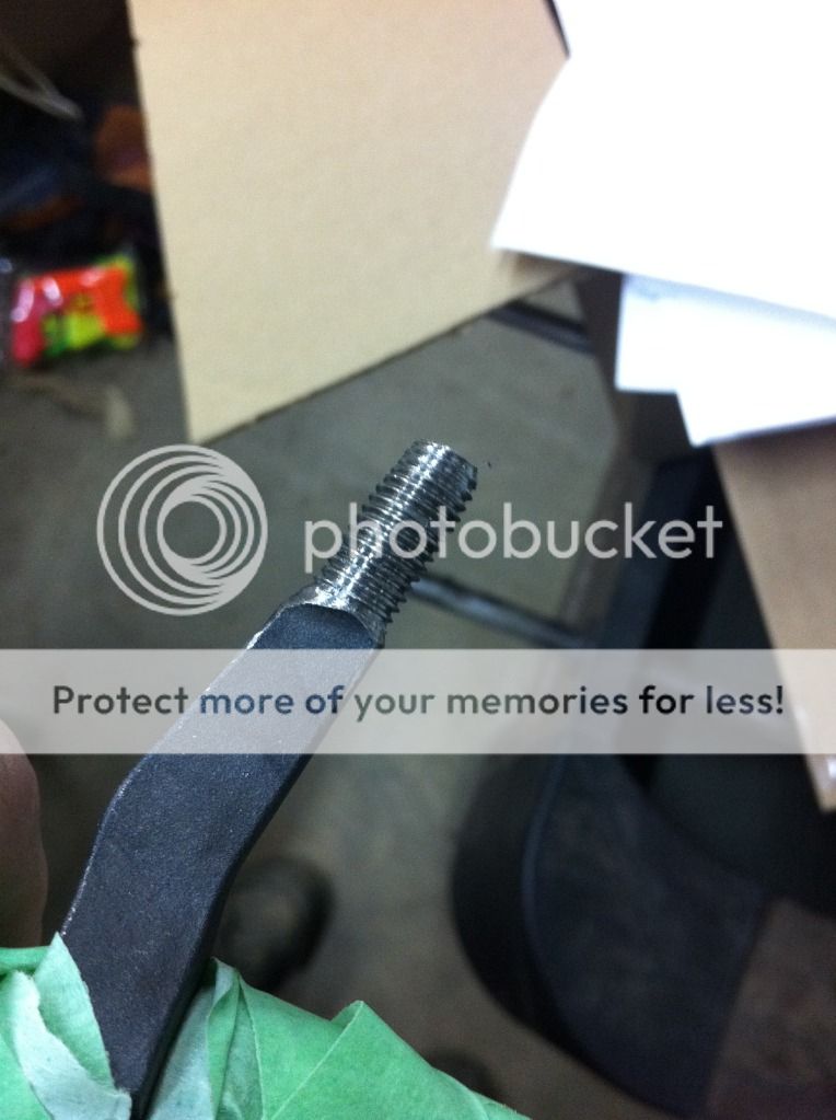

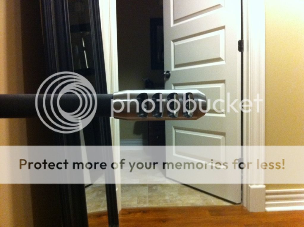

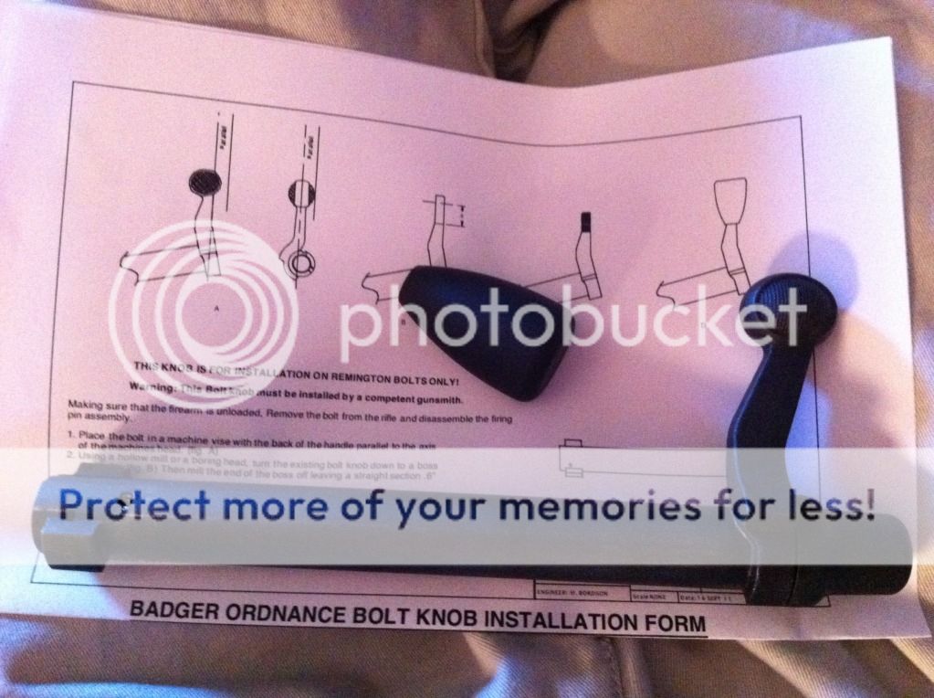

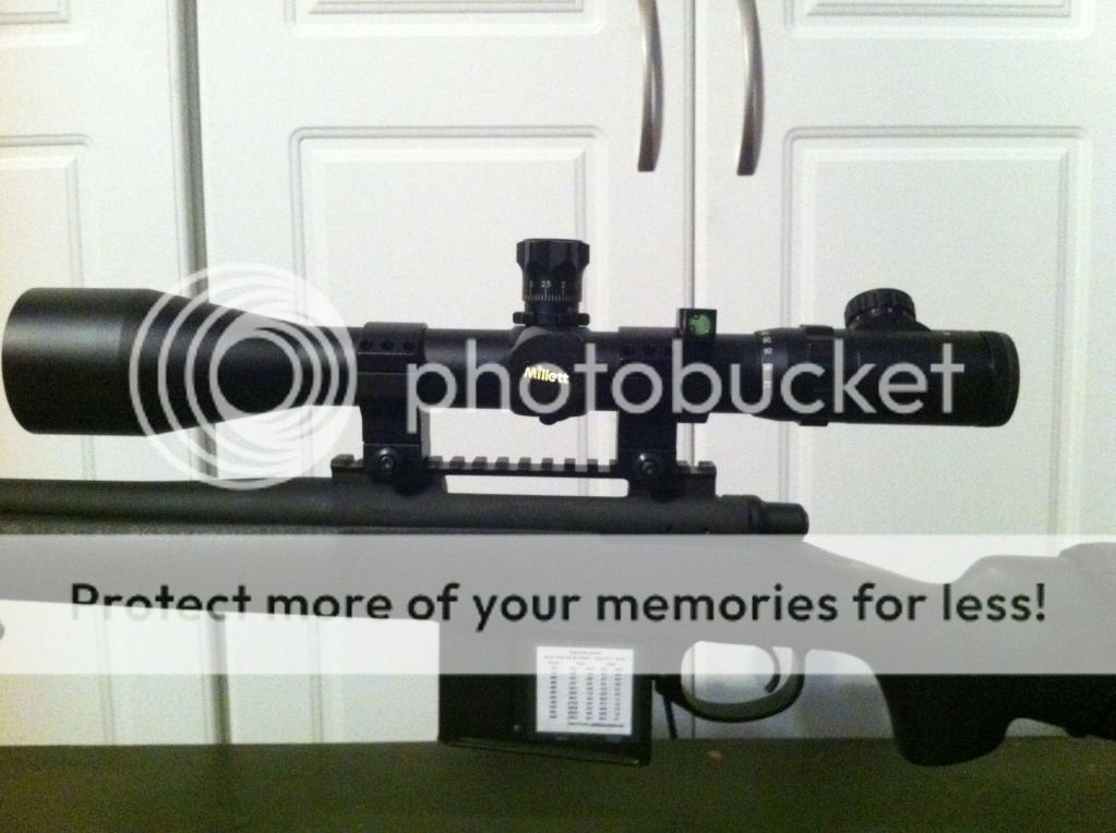

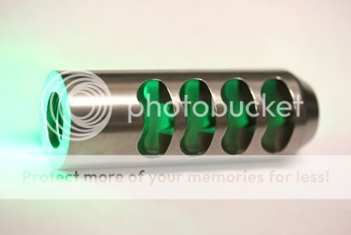

First thing was to upgrade the optics, I replaced my Millett LRS with a Nightforce NXS 8-32x56 and set it in TPS rings. Then I installed a Badger Tactical Bolt Knob by grinding the bolt down and filing it round (0.313") and threading it (5/16-24 TPI). The final upgrade is a APA Fat Bastard Muzzle Brake. To install the APA Fat Bastard Brake I had a fellow Gun Nutter, coyote, machine the brake (bore out from 7mm to 0.022" over .338" and indexing).
Scope Change
Old Scope

Badger Tactical Bolt Knob Install
Removing material from the Bolt
Threaded
Knob Installed
Brake Instillation
As it Arrived
Final Fit
I had it out last evening and everything worked well. The glass is very impressive, tracked great and is very clear. The brake has taken the recoil down to well below a .308 WIN, plus no more debris flying from the downward ports on the old brake. I am very impressed with this brake. The knob is a great addition as well.
1st Test
I am going to make up a few rounds and test this new setup, but it grouped good with some rounds I had kicking around the ammo cabinet. I may also put a level on the scope, I know it made a big difference when using the Millett.

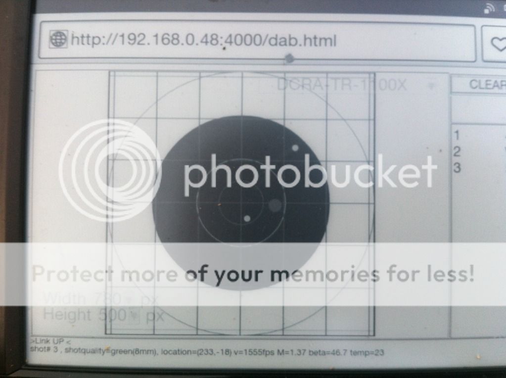

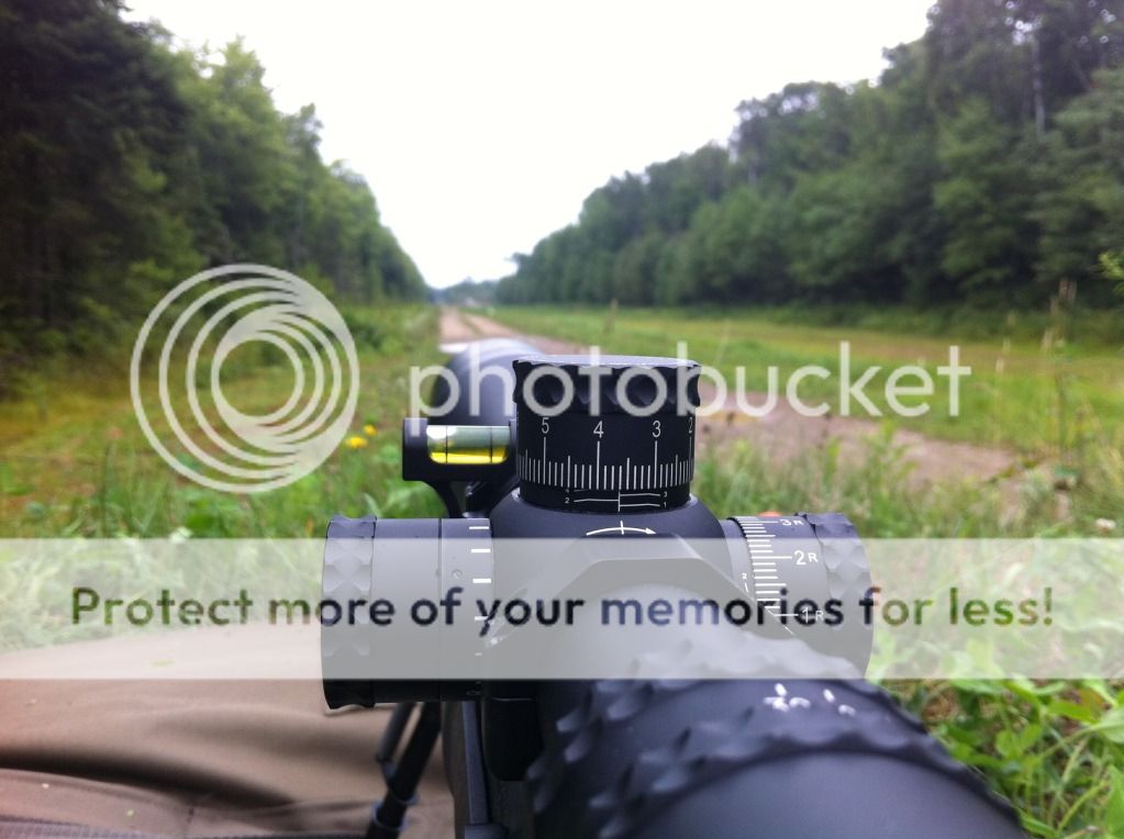

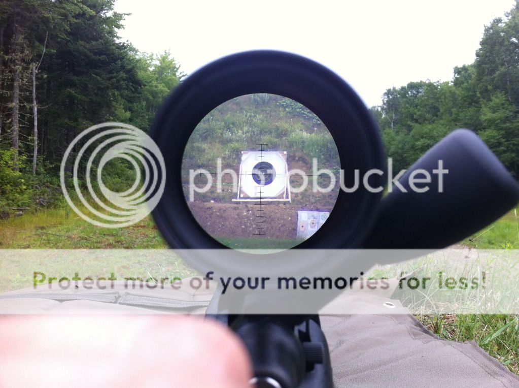

I went to the range yesterday and tested out the new setup. Everything worked great! I shot 300, 600, 800, 900 & 1000 meters and had a great day. Thanks to rnbra-shooter for the use of the electric target system he brought. Also, I installed a Flatline Ops 30mm scope level, it works better than the Vortex I used on my Millett. Enjoy the pictures!
Scope Level from my view
View through the scope from 600m
Target @ 1000m
Upper right round was the first shot, center shot was the second (after corrections) and the larger dot is the final shot. I was out of ammo so I couldn't get a 3 round group.
