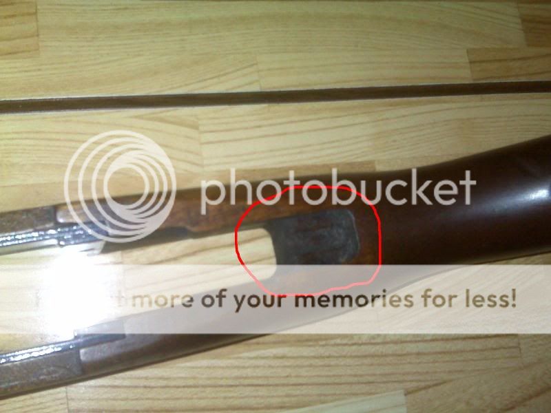

I just picked up a wood GI stock for my norc. Happy me until I install it and do a function test. Now when I cycle the bolt with the trigger depressed the hammer falls. Not good. What gives?
Your safety sear is not engaging. And why is the safety sear not engaging? well I will tell you. It is caused by the thickness of the stock. The distance between the receiver and the trigger group is a tad too much. CAREFULLY remove material (wood) from the areas that contact the underside of the reciever and trigger group checking all the time for the safety sear to engage and the proper "squeeze" of the stock between the receiver and trigger group.
Wizard, is this the area you're referring to?
YEP ...

Well, I took a little material off in the suggested areas and I think I've met success. Thanks to the auto selector cut-out in the stock I can clearly see the safety sear engage as I cycle the bolt now. A range visit is necessary to confirm but I think I'm good to go. Thanks guys.
