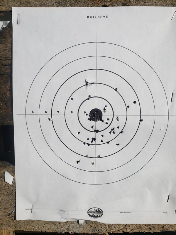

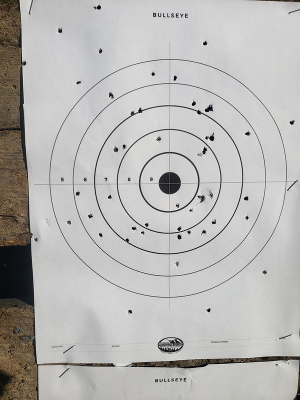

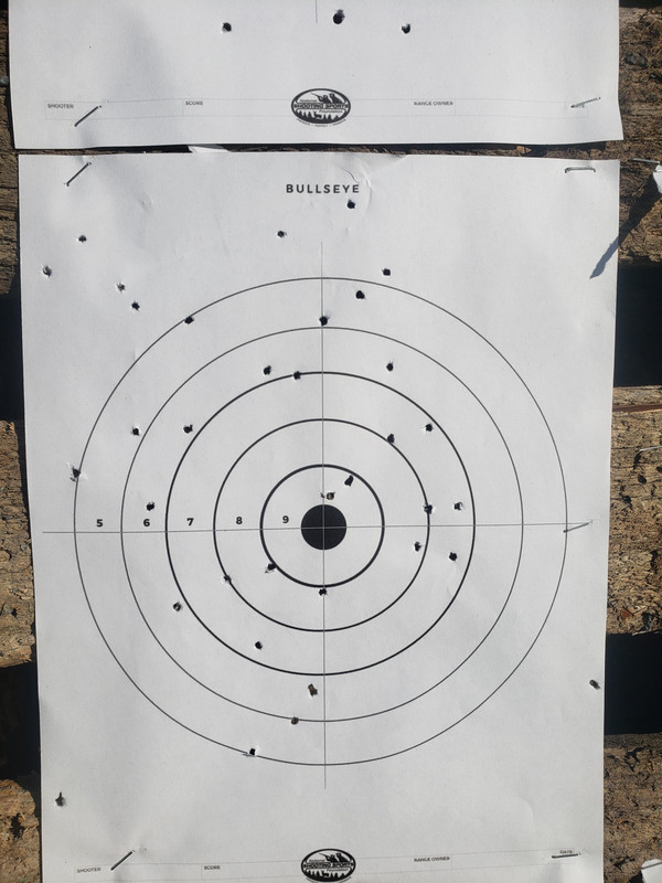

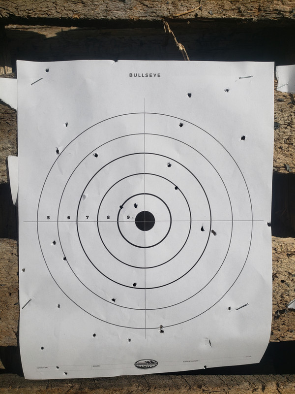

Alright, despite the wind I did some quick testing. My shells are .45 colt loaded with Speer shotshells. Each capsule has 35 #4 birdshot pellets inside. You don't need capsules I am just lazy and find them convenient. Shot from a 24" full choke Mossberg 500.
5m
10m
15m
This is what I would call the effective range of the shell. You can see from the 20m target that it all turns to crap.

20m
It's just some preliminary testing but I am pretty interested in this so far. A .454 could hold a fair bit of 7.5. No need to use the capsules you can make a gas seal out of whatever and cover the top with a cardboard disc.
