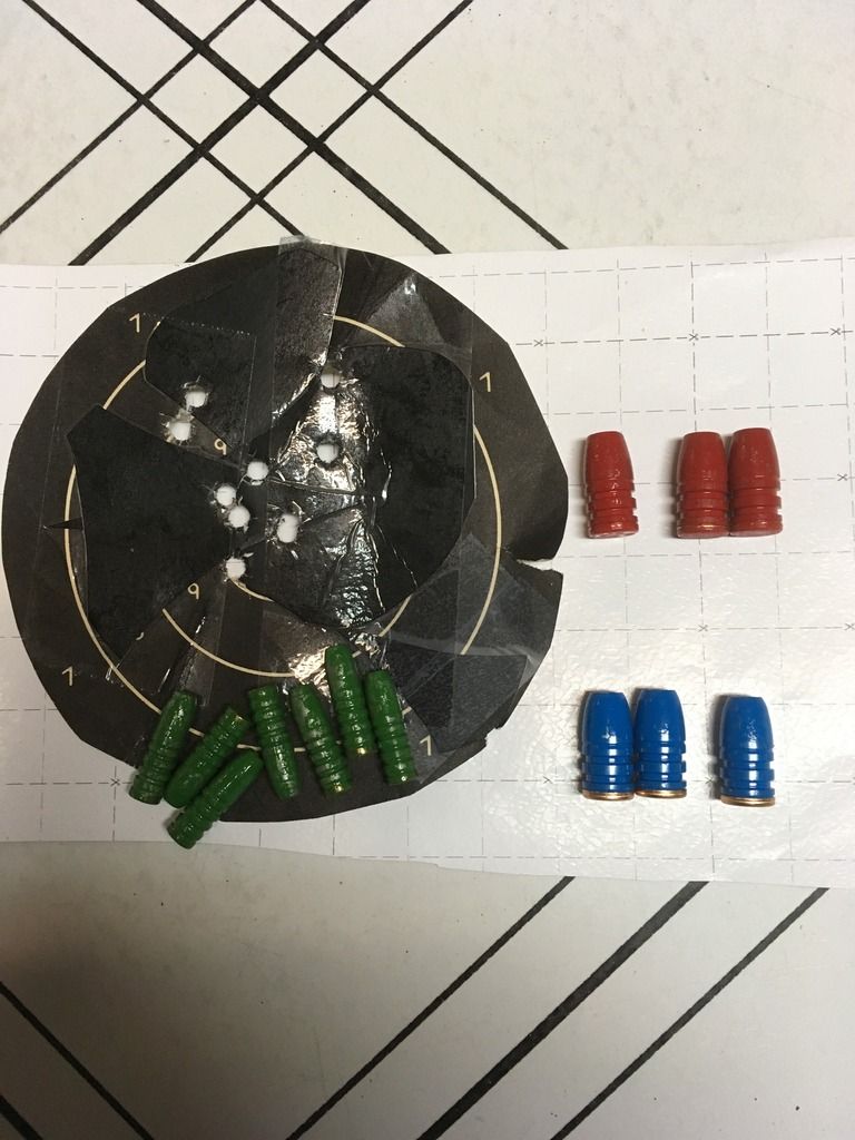

The current wisdom is that Tool Blue and Tractor Red from Emerald are best, and they give the most uniform coat. The powders from Princess Auto and Harbour Freight aren't quite so good. A friend gave me some lime green to try and it gave an anemic and blotchy coat that didn't look very inspiring. However, I have a Sharps .30/30 that has a very snug chamber and leade and I couldn't size the nose enough to chamber in the rifle. I tried both an NOE nose sizing die and an Eagan nose tapering die and they would deform the bullet too much, before they could chamber. As a last resort, I tried coating them with the lime green powder, and the thinner coat allowed them to chamber easily. As the 100 yard group of just over two inches shows, they can be accurate and the m/v was averaged at 2050 f/s with my Labradar. So, I know that I'll have to rethink the value of the cheaper Princess Auto powders. At $7 for a half pound, it's a no-brainer and I drive by the local one at least once a week.
