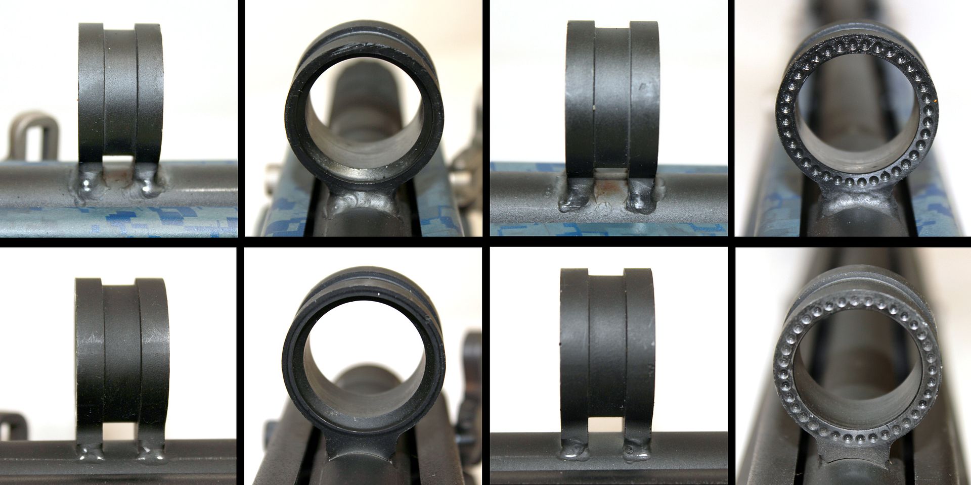

UTAS have announced that they will be supplying new barrels at no charge for all the UTS-15 shotguns that Wolverine Supplies have sold in Canada. Some barrels have already been replaced, they are good to go. Please look at the following photo to see the differences. If your barrel lug is attached to the barrel with four small welds it will be replaced. If your barrel lug is attached with four small welds and two beads of weld you are good to go. The top row of photos show the correct weld.
The UTS-15 barrels have the serial number of the gun on them, due to the firearm regulations in Turkey so the replacement barrels will have the same number. This means that these barrels will be supplied on an exchange basis. We will be announcing here when the new barrels are available.
