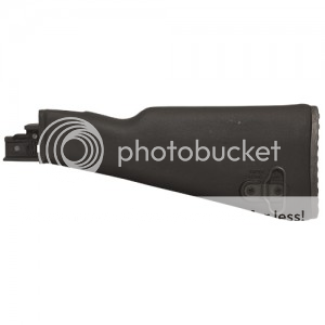

Would you be able to Draft up something that accepts Ak stocks with the tang on them??
I _can_ draft up an adapter even for that tanged stock as is... but it will look like s... it will look bad, k? ;) Too long and you'd be _very_ limited in material choices - the adapter will have to envelop the tang and then be strong enough. If someone wants to donate an AK stock to this or be willing to do a lot of measurements?

You may find that if you take the buttplate off, there is a bolt that attaches the stock to the adapter. (Not the case for wooden ones) One of the fiberglass stocks I've seen was done that way.
If that's the actual stock you want, can you pm me the link to the store and I'll see if I can get some hands on it when I'm in the US (or get someone to examine it for me).
Also see if you can find a Yugo M70 stock - they are definitely done with a bolt (no tang). And I have an adapter I can modify for those if the holes don't quite line up with a stamped receiver (I believe they don't - there are two horizontally?). If you need one for a cast one, I'm in the process of making one now.
Otherwise, mod time - you can cut the tang off the stock to get a flat surface, then drill lengthwise (you probably know, but for my own sanity, I'll say that you should actually drill toward the buttplate, and use a drill press to get proper alignment). One hole or two is up to you. With one hole you may not need an adapter. But with two you'll get a firmer fit with no chance of twist, but a thin adapter will be needed (5mm or so) and I can draft one up.

Well that buttstock is a Tapco one so really any good firearm store in the states should have it if not I could try and order the stock but i highly doubt that it will be shipped up North.
I think your idea is the best way. Chop the tang off and drill holes for bolts thru the stock and attach it to the stock adapter.
Thinking this could work out good.
