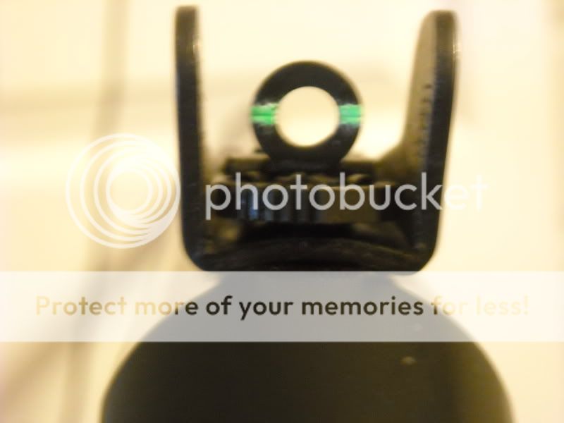

I know this shotgun is pretty rare in Canada, but I hope I'm going to hit a couple of Valtro PM5 owners out there with this thread. Need help: whoever owns this shotgun - please tell me how to adjust elevation on the rear sight? It's a ghost ring sight between two rails; a screw adjusts windage, there is a wheel at the rear of the sight, but no matter how much I turn it, the shotguns shoots really high. Also, it's impossible to turn that wheel full turn either side without actually lifting the ghost ring assembly.

"if" its the mossberg ghost ring then that wheel spins up and down on a threaded pin, all you need to do is lift the ring slightly and rotate the wheel up or down for elevation.
there are a few factory sight options but mine is a mossberg rear ghost ring and a front rifle sight if that help's.

Thanks everybody who answered. Nice to know there is help out there....Hotwheels81, looks like I've got the same gun. Will try your suggestion tonight. Just to make sure - I have to turn that wheel clockwise in order to lower the front sight, right? Reason for asking - tried to do that already with no result. BTW, do you know if putting a muzzle break instead of a choke will reduce the recoil?
raise it to lower POA and lower it to raise POA
your shooting high so you will need to turn it counter clockwise to raise the rear sight to bring your POA down....

I agree with chopper 1, it's the only thing that makes sense. I also have trouble with my Valtro shooting 3-4" high, and my rear sight is at the lowest setting. Bloody embarrassing to have spent $800 for a pump action shotgun and be stuck with a too-long stock and incorrect front sights. Valtros site does indeed show an orange bead sitting on top of the sight.
Anyone know how in hell to remove the front site on the Valtro? I haven't the foggiest...
Peter take the mossberg GR off, your PM5 was not made to have the mossberg gr's. the front sight is the stock slug type, shoot it with only the front sight, night and day diffrence. take the GR off and try it out. quick and very accurate.
