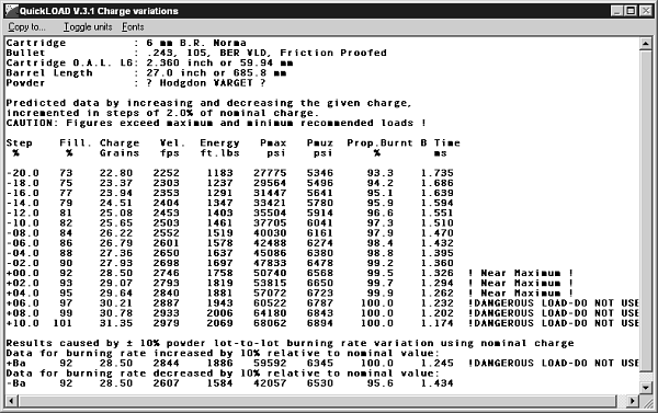

The questing was " Is it possible that varget doesn't have enough time to burn completely in 20" once it is loaded this heavy?"
I will say the powder will be burnt, but you will have residue.
