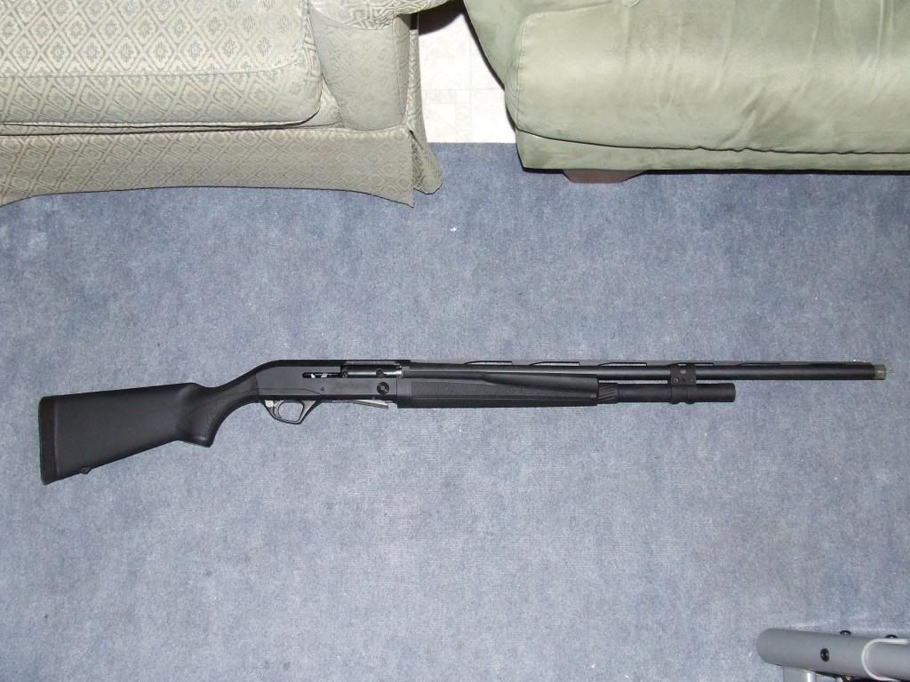

I went with a Sportsman as well (28").
Stocks - I ended up just shortening mine myself to my preferred LOP and with a kydex cheek riser. Looks like crap, but works well enough. I'll be building my own adjustable stock with shell carrier in the near future.
Mag extensions - I'm cutting my own clone of the Carbon Arms Versatube, just waiting on the cutters to arrive. It'll be an aluminum spacer rather than the fancy carbon fiber one though. I'm also replacing the fore-end with a slimmer kydex one.
Barrels - I had mine shortened by Briley through Lawry Shooting Sports, ran about $400 including 3 extended steel/tungsten shot thin wall chokes - brings it pretty much back up to the Tactical in price for the same barrel length but with a 3.5" chamber, and missing the fancier furniture.
Lifter - I've been practicing load 2 (strong hand) and with my particular technique, I can't seem to get my thumb stuck under basically any conditions. Doing traditional weak hand loading, I definitely can and do get caught. For now, I'll probably leave the lifter alone.
Safety - the stock safety is pretty well sized already. Were you looking for both the on and off sides to be enlarged?
Charging handle and bolt release - I made these myself:

Was thinking about the sportsman but got the VMT instead...less work. no barrel shortening and already comes with an extension (just need to remove the washer and put a permanent plug).
One thing on my wish list to an aftermarket stock...perhaps a magpul sga would be nice, not into the pistol grip. Original LOP was a bit long for me. Replaced the buttpad for the one on my 870, reduced it by half an inch or so. Another half inch would be great (that's what she said).

This is also a good mod to do if you find pushing the shell rim past the latch a bit stiff:
http://www.brianenos.com/forums/index.php?showtopic=183566&hl=
I too have found that the load two method is fairly safe so long as you bend your thumb properly. It may vary for hand sizes, but, I find that so long as my thumb is bent to be inline with the two shells as I stuff them in, I can let the lifter ride over my knuckle! and I am able to extract my thumb snag free. It really just comes down to practice and muscle memory. This technique should be okay for the newer quad load method as well

I went the same route with the Sportsman
Stocks - haven't looked into any, I believe the Mesa is the only one. I'm happy with my factory stock for now.
Mag extensions - I run a Nordic, Freedom Ventures brought some in, I also got one from a different source (pm for details if you want), but Freedom is awesome to deal with. Curious to see what SFRC comes up with! I'd be extremely interested in somebody either brining in or producing something like the CA Versa-Tube
Shorter barrels - I'd be interested to see if Tacord can do a chop and thread. I emailed Gravel about getting one as well, prices aren't terrible (for some reason the zombie and mossy oak 22" barrels are cheaper than the plain black ones by a considerable amount)
Shell lifter - I know Casey brought in some TT ones as well, but they are shorter and seem to give mixed results depending on thumb size. I'll probably get mine welded when I have some spare cash, but like others have said it varies. I've also found the load 2 method (either hand) to not give me any issues, load 4 pinched my thumb something fierce.
Safety - the factory one is already oversized and reversible, unless you're looking for even bigger.
Oversized charging handles/bolt release - I run Nordic on mine as well (see my mag comments). Most Benelli compatible parts should fit though.
The only other thing I've done is notched out the shell latch and lightly polished it, made loading much smoother.
