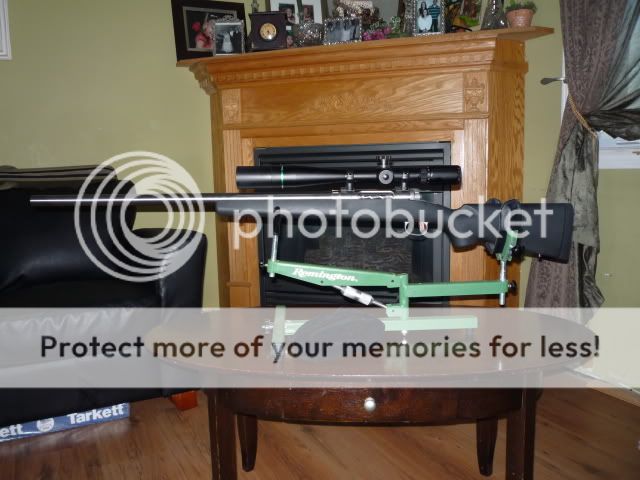

Was doing some load testing with my Shilen bbl'd LRPV. Shot the groups below consequetively with no cool down between strings. The top group should actually be rotated 90 degrees. Any suggestions?

Did you use that rifle rest? That might be moving enough to cause vertical.

It is bedded. It was shot with a firecontrol front a protecktor rear bag. My scale is dead on against an rcbs balance...using a loadmaster. I did have quite a bit of mirage as the bbl heated up. I will try again and wait longer between strings. Any direction on powder increments?? I am at the published max load.
