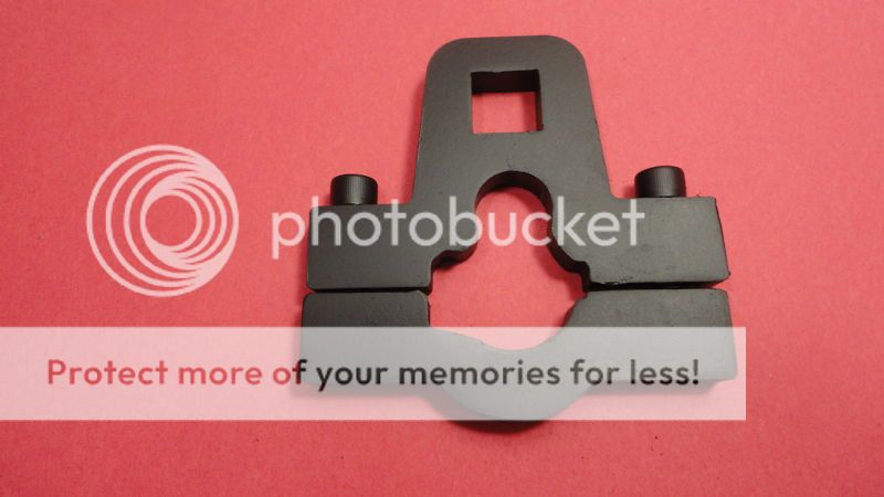

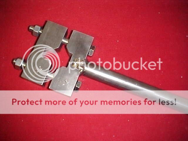

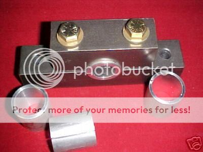

This is the vise I use below I don't think it will break any time soon. What I am looking for is a receiver wrench to remove the receiver from the barrel like the one below second picture I may make my own but if I find one it would be better.
I would advise against using a vice ,they brake easy. unless you have a plumbers vice. oak blocks and rosin work well when clamped well.
You fellows should check out Gunrunner8.
He makes up very similar bench vices as maxinumarmor is so pleased with and will make up any bushings to your specs as well.
He also makes up a very nice internal wrench that you can use with a Johnson Bar/7/8in socket. It works very well.
I have been using external wrences for years, drilled and machined to shape then weld on handles and line with brass shim stock so that I don't marke a receiver ring.
Roman convinced me to try one of his internal wrenches and they work perfectly.
Have a look on the EE, he has pics of his wares. They are strong as can be and extremely well made. They also fit most actions. So far, I've used it on Remingtons, Winchesters and Mausers. No fuss, no mess and above all, no galls.
Gunrunner8, is in Kamloops so shipping should be reasonable.
