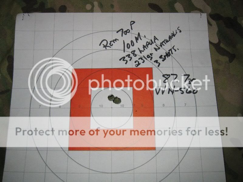

I use VV N560 for my 338LM. By far the best I've ever used. Other than healthy doses of Varget for 223 and the 308 family..I use all VV stuff. The 500 series has more nitro, so you actually use a little less, for good vel. Very uniform..I have nothing but good to say...as long as you can find it..
